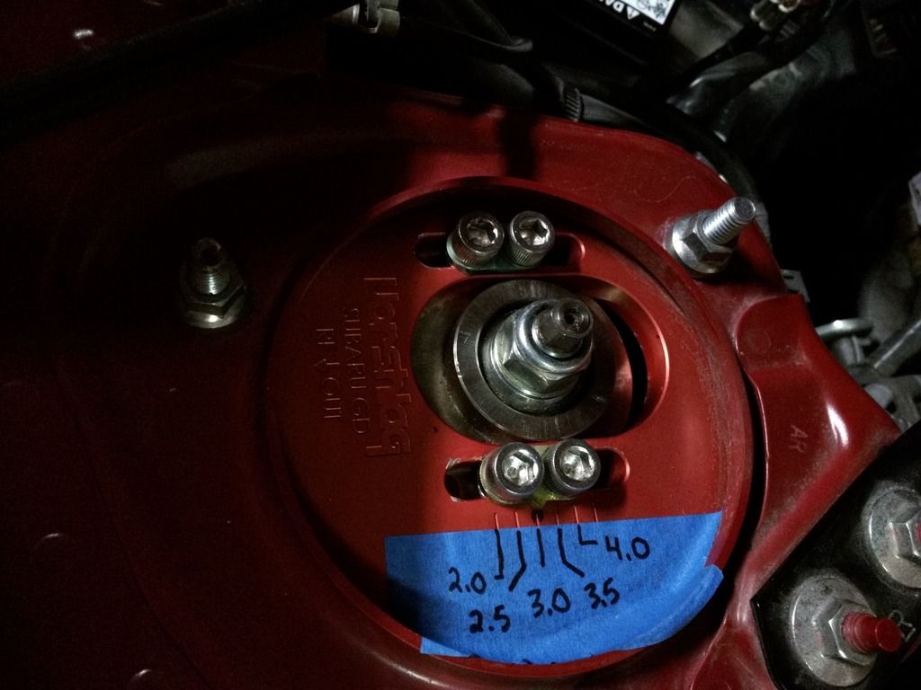

I just do the plate adjustment, zero toe at max camber, the front will toe out as you go positive camber so if you need less camber for an event you'd get a touch of toe out which isn't a bad thing.
Going more positive for driving back and forth to the event, balancing how much toe out you want to live with, got solid wear out of my ZIISS with that strategy, ~20k miles and a season of non-competitive autocross, ~3 track days.
You could also figure out a toe adjustment between an autox and street settings to do at home pre/post event, a simple string box in your driveway and a weekend of tinkering, turn tie rods X times to go between street/autox, should be pretty easy to replicate and not a huge time sink.

My driveway is nowhere near flat or level so a diy is kinda out of the question. I think the zero toe and might have the shop mark the plates at -2.5 and -3 to adjust more simply will be the ticket til I get my daily wheels in Summertime. Then ill just get cheaper tires to daily and not care if the alignment hurts them a bit lol

For anyone with plates who goes in for a custom alignment, it's worth having the tech work through a few different settings on the plates to see what values they generate. If your plates don't have markings, add some. That way you don't need to cough up more money if you decide you want 0.5 degrees more camber in a couple months.
This is a very good suggestion and shouldn't add much cost to your alignment if they know when they're doing.
I did mine at home and it took very little time.
