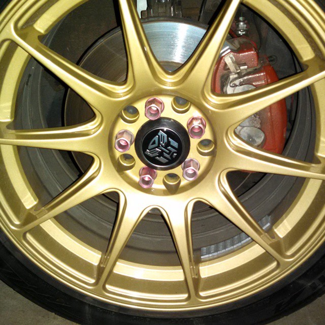

XXR 527 17x8.25 et 35 in gold

Greddy Short Lug Nuts - Red Open Ended
55mm center cap decals (Autobot) for XXR 527 wheels

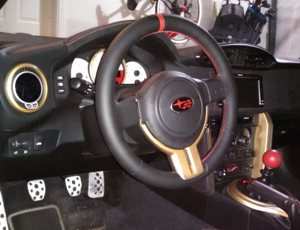

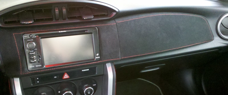

JPM Coachworks Alcantara w/ red stitch gauge cluster hood
Flossy Red Griptape Shorty with custom emblem
Perrin black ebrake knob
RedlineGoods Alcantara wrapped OEM steering wheel with red center stripe*sold*

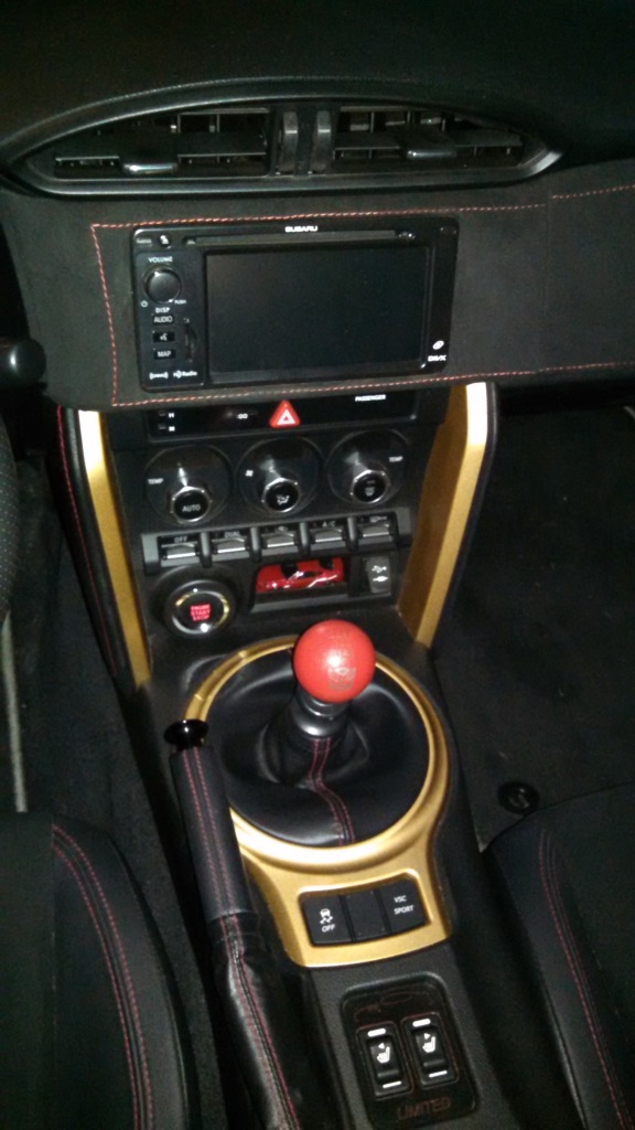

RedlineGoods Alcantara w/ red stitch radio and air bag surround

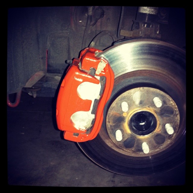

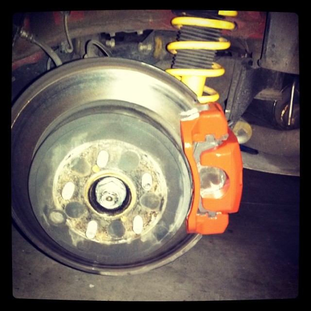

Paint brake calipers red with G2 paint

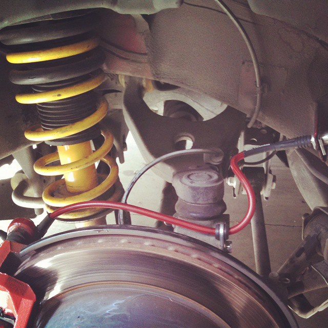

MTEC Industries Stainless Steel Brake Lines

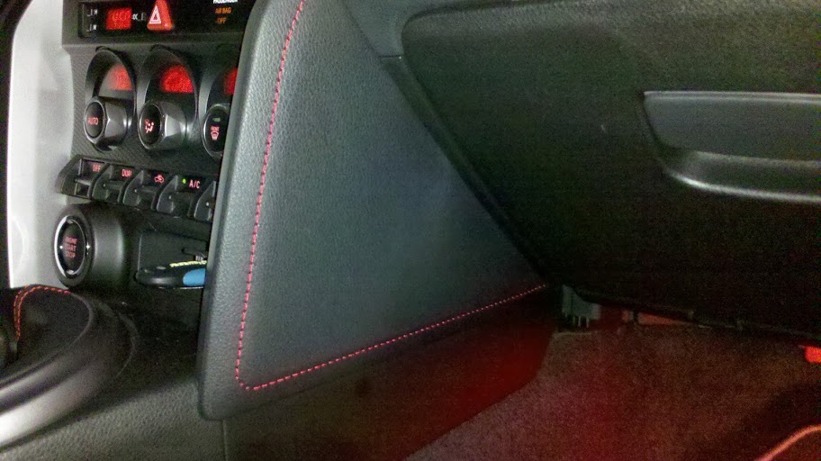

I installed the leather with red stitching knee pads as shown in this thread.
http://www.ft86club.com/forums/showthread.php?t=13583

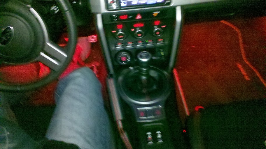

Installed red led foot mood lighting. The pictures don't do it justice. I installed based on the following thread by using the glove box power. I didn't plus the 12v back in as I just used ends that could plug the lights into the plug the 12v was using.
http://www.ft86club.com/forums/showthread.php?t=14614

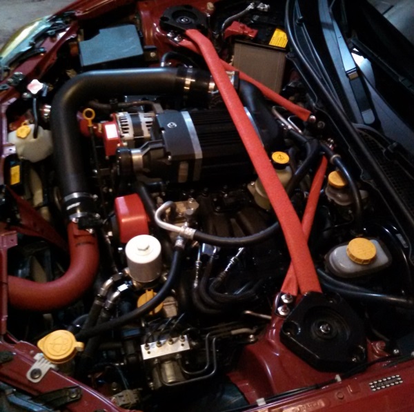

I installed the Perrin red intake hose and red cold air intake system

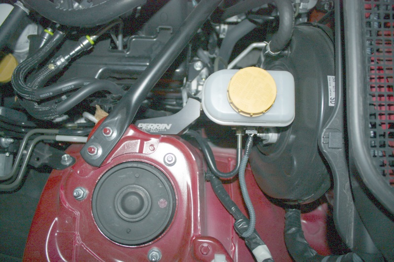

I installed the Perrin master cylinder brace

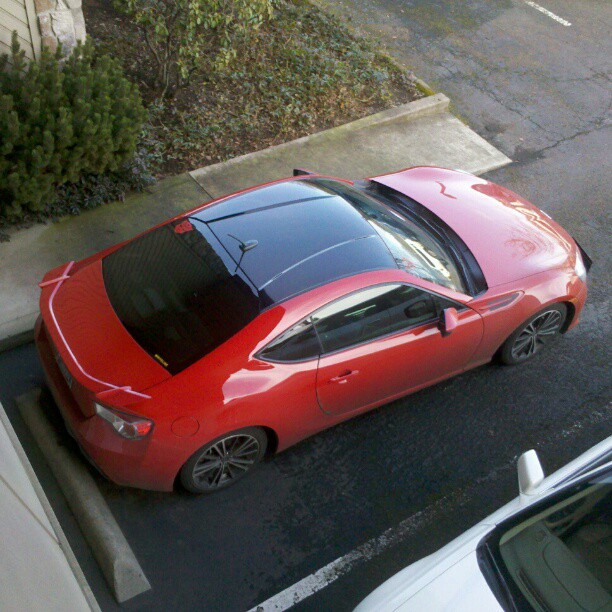

I had a gloss black roof vinyl put on

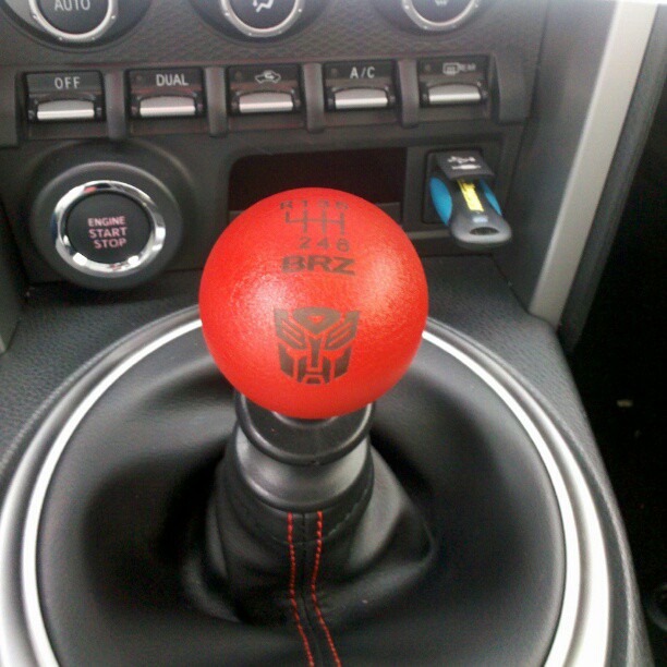

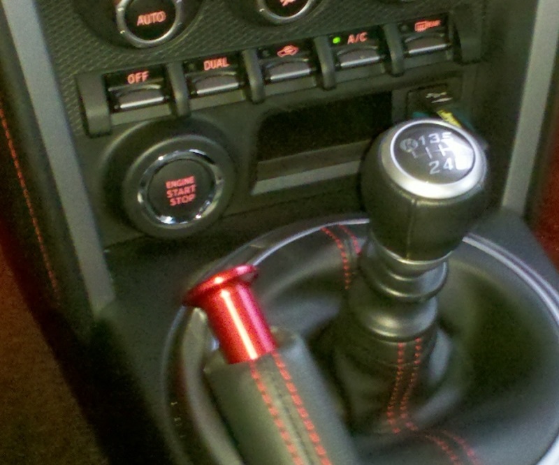

My Flossy red shorty came today!
Name:  Flossy knob autobot.jpg

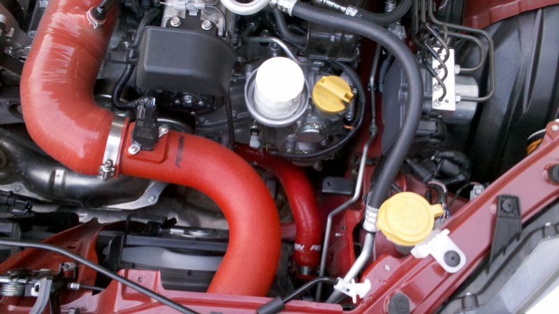

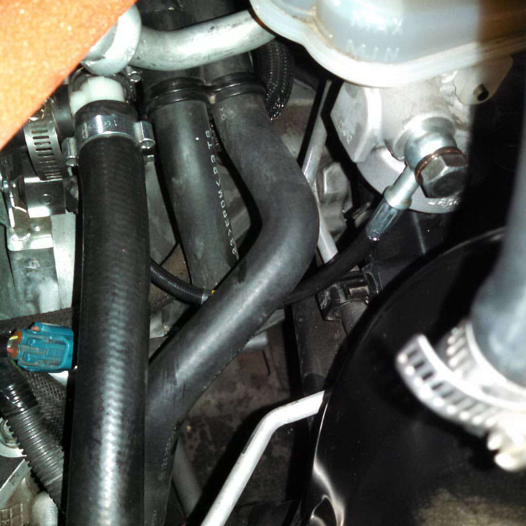

Perrin radiator hoses in red
Name:  rediator hoses1.jpg
Name:  radiator hoses2.jpg

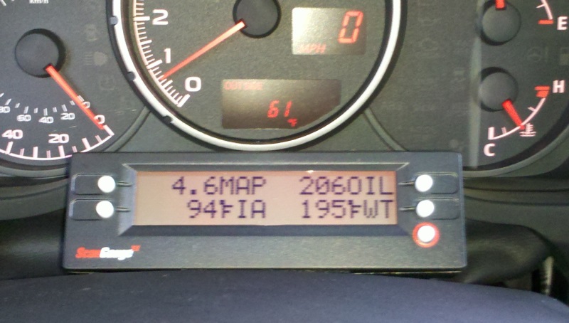

Added a ScangaugeII to the car. Now I can see important info without spending tons of money on external gauges. I mainly bought it for oil temp for before and after I install the Perrin oil cooler. For only $128 on Autozone.com it was a deal. Shows all kinds of cool info.

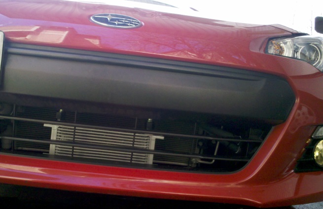

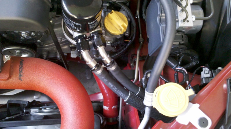

Perrin Oil Cooler Installed
I installed the Perrin oil cooler last night. After driving around today with the Perrin oil cooler I'm seeing oil temperature decreases of around 20 degrees. Obviously the more air flowing through it, for example when on the freeway, the lower the temperatures will be. I was at about 180 when on the freeway after driving around for a while, instead of the 205ish area before installing the oil cooler.
The install was easy and straightforward thanks to great installation instructions included with the Perrin kit. Basically take the front bumper off, install the kit, check the kit, and put the bumper back on. That's the super general version of course. I think it took me about 1.5 to 2 hours from start to finish.
Name:  oil cooler1.jpg

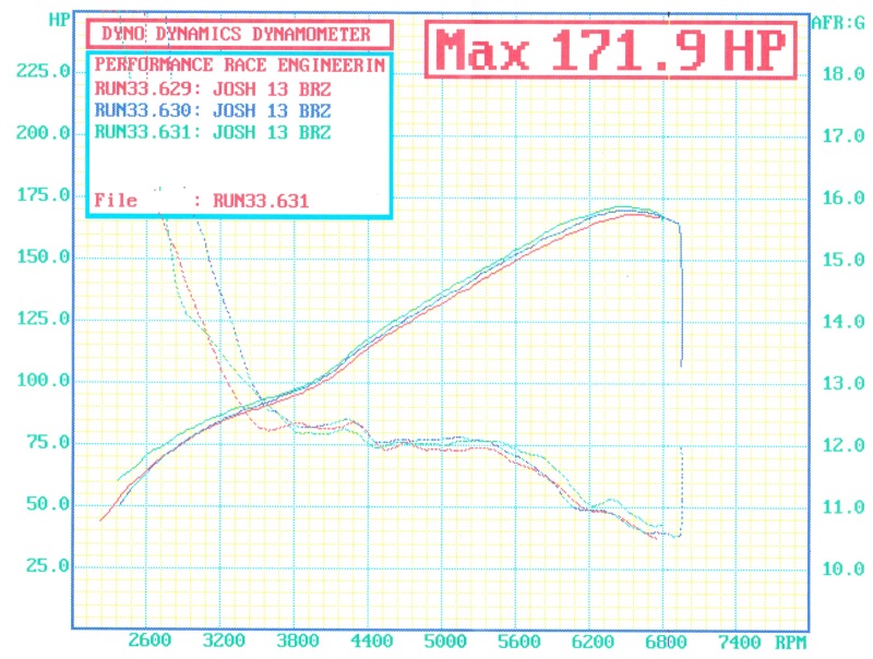

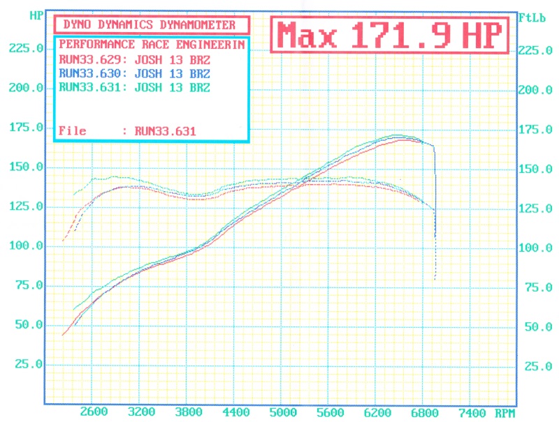

Got my car dyno'ed today on a Dyno Dynamics machine at PRE in Portland. I have all the above goodies on the car. Still haven't gotten a tune yet. Turned out I got 171whp which is about what completely stock cars are getting without having a tune. I'm planning on waiting to tune the car until after I install headers. Bolt on stuff doesn't add power without a tune it seems.
Alcantara w/ red stitch radio and airbag surround from Redline Goods. I'll do JPM Coachworks next time as I had to install it myself and I couldn't get it perfectly lined up or looking quite like it should.

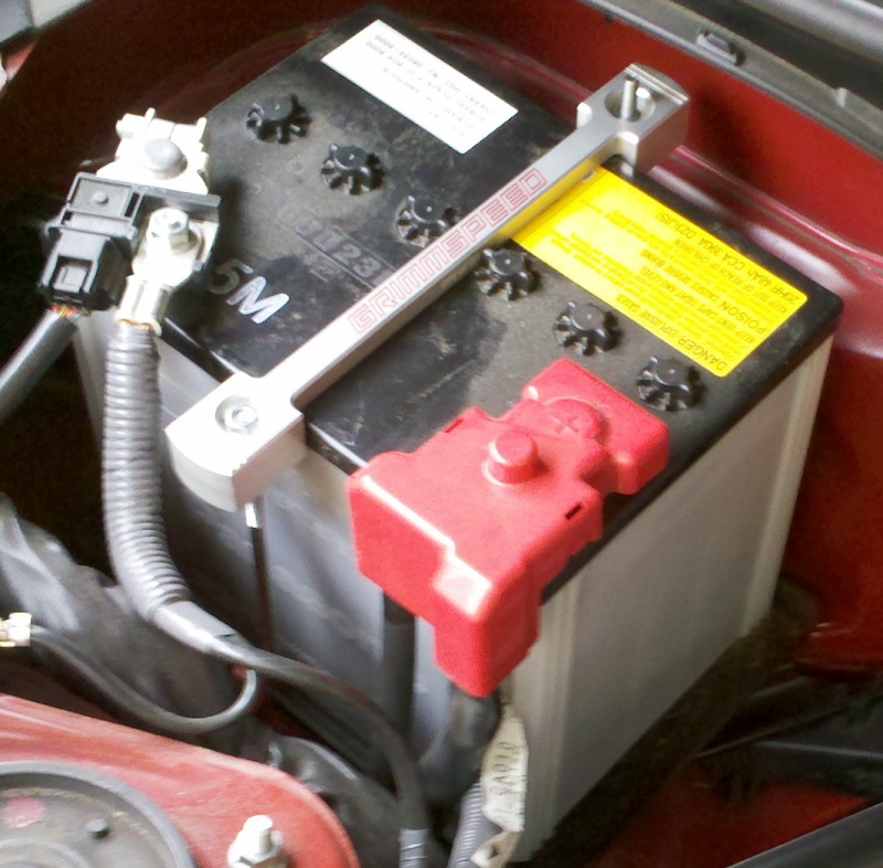

Grimmspeed Oil Cap & Battery Tie Down installed (sold later as the oil cap was too hot to touch and battery tie down was difficult to attach/remove.
Name:  grimmspeed battery brace.jpg
Name:  grimmspeed oil cap.jpg

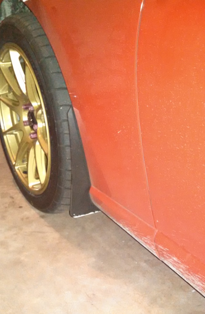

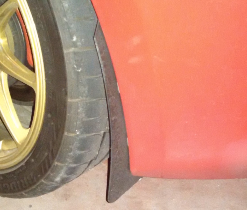

Added OEM splash guards (mud flaps) to the car and also painted my wheels logo red.

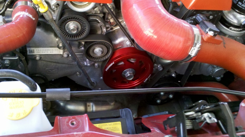

Since Everyone else seems to be getting the Perrin crank pulley I figured I'd join the crowd today. Install was a breeze. I'm not sure if it's actually doing something or if it's in my head but the car seems to slow down less when letting off of the gas and perhaps it feels like there's less resistance speeding up as well. So hard to tell.
Name:  Perrin Crank Pully Red.jpg

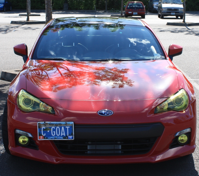

LaminX yellow headlight covers installed by a window tint guy as it was impossible for me to do it myself. Hopefully I don't get a ticket since this is illegal here.

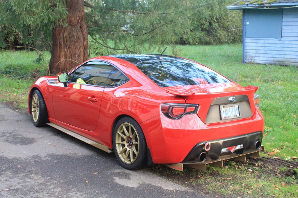

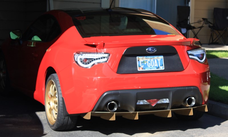

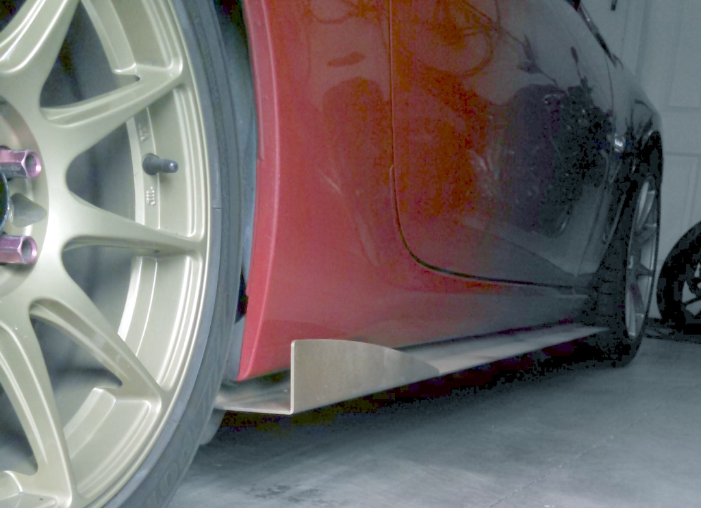

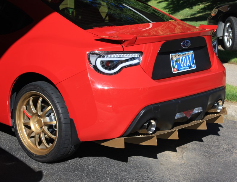

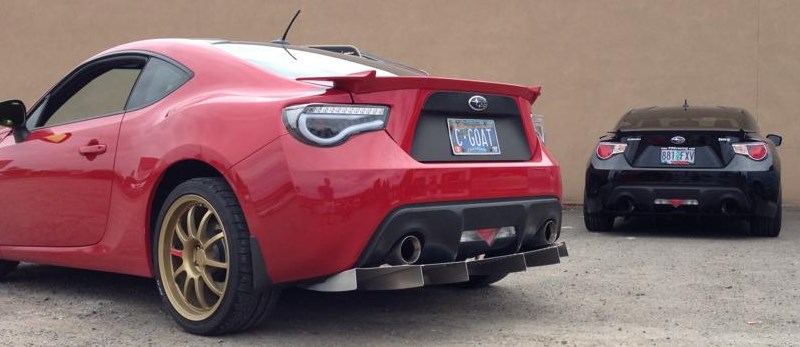

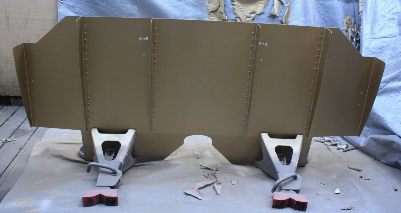

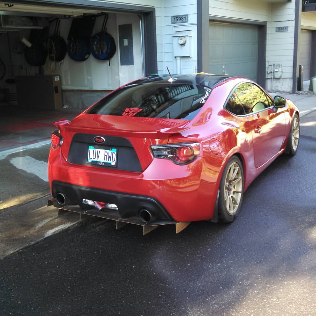

Rear Diffuser installed and painted gold. Created by Carl Lee (@Wonderbar) company is called Driveway Labs.
This is Carl's first attempt (after his prototype) to make a rear diffuser. He produced 5 based on his prototype. It looks good and install is pretty simple. I've received may complements already. Since it was his first go it's not perfect but worth the money I paid for it as it's a custom hand made, with the help of a laser cutter, rear diffuser. Once he makes more goodies like this I'll be hounding him for those bits as well. Before you read below I'd like to say I really like the diffuser and would definitely buy it again if I didn't have one.
Positives: Looks good. Non-intrusive to the underside, does not scrape the road, nice lines, durable, good idea to use sway bar bolts to mount the backside of it, plastic push pin things were a good idea, fins are a nice medium size, rivets are nice, overall a nice piece. I think I'm seeing a slight increase in MPG but only when on the freeway cruising on a flat surface or downhill where minimal gas pedal pressing is required.
Needs Improving:
1. He designed it based on the Perrin exhaust, not the stock exhaust mid pipe so the hole in the metal is in the middle instead of on the left which decreases the efficiency of the diffuser a little. I would definitely like to see the hole in the proper spot and wonder if I can fix it somehow by getting a small piece to cover up the hole. Another small thing with this is I'm required to use the mounting holes that make the diffuser lower to the ground instead of more flush with the bottom of the car. It's minimal but could help air flow if it matched up to the underside of the car with the proper exhaust cutout.
2. The mounting of the sides is held up buy Phillips screws. I'd like to see something a little more sturdy and more OEM looking. perhaps drill a little hole and use more pushpins instead was the first thing that came to mind.
Things I'd like to see:
Aside from the already mentioned hole in different spots for different exhaust setups, I'd like to see possibly 2 fin options or maybe 3: short and long. I think the side fins could hang down a little further than the ones in the middle to give it a little extra style and possible functionality. The fins towards the front of the car could probably hang further down (bigger) since the axle is there but I'm no fluid dynamics engineer or whatever they are called.
I highly recommend this product and really enjoy having it on my car. Hopefully my constructive criticisms doesn't sway anyone from buying or wanting one. I'm a quality assurance engineer so it's my job to give detailed info on stuff. Overall I'd give this product a 8/10. With the couple things I mentioned that need improving I'd give it a 10/10.

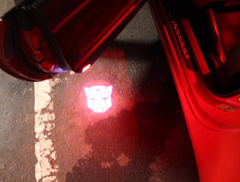

Car door laser Projector autobot

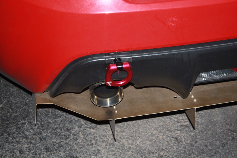

Raceseng red rear tug tow hook (they also have a gopro mountable version) (decided to sell later as I'll never need it and it's a form over function item)

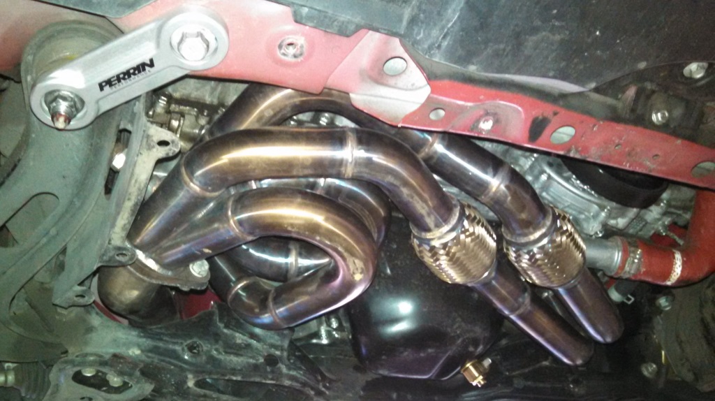

JDL UEL headers, o2 spacer for catless header, Grimmspeed header gaskets were installed tonight. Here are a couple videos of the install. One is windows up and one is windows down. A little louder when on the gas and about the same when coasting and at idle. The videos don't do it justice.
[ame="http://youtu.be/q0DGi_wZlWg"]http://youtu.be/q0DGi_wZlWg[/ame]
[ame="http://youtu.be/JxquqUm8cyM"]http://youtu.be/JxquqUm8cyM[/ame]
Name:  JDL headers.jpg

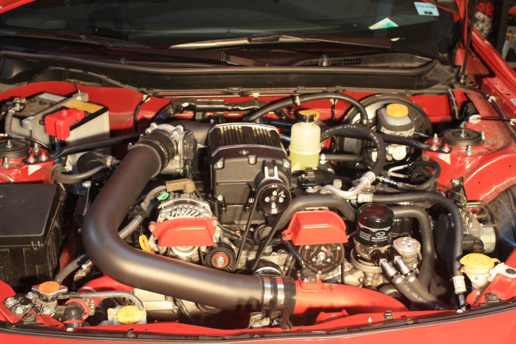

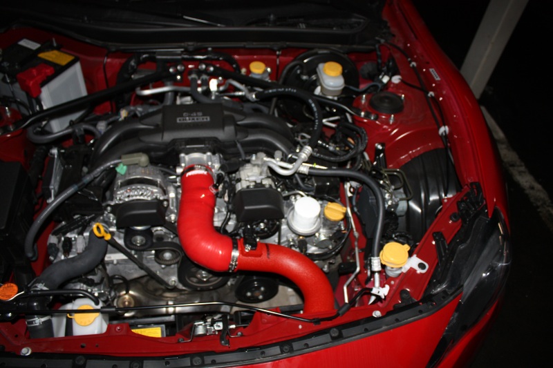

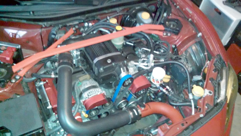

I was lucky enough to be asked by a fellow car member if I'd like to buy their Innovate supercharger from him as he was parting out his car since he was selling it. He offered $2k so I said sure. I wasn't expecting to spend money or buy anything but an offer like this doesn't come every day so I took it. Here's a picture of it and the dyno. The air wasn't nearly as dense as it was on the last dyno. i can definitely feel more power so I know it's there. It makes a nice whine but I'm hoping I can make it louder by replacing the Innovate's plastic intake pipe with a metal one. Commuting to work has become extra fun!
Name:  dyno after supercharger.jpg
Raceseng 70mm pulley for innovate supercharger Added
Nameless Performance Innovate intake pipe added
Innovative Sprintex Supercharger intercooler added
The numbers aren't impressive but not horrible. I've hit the wall on this kit and the only thing I can do running 92oct gas is to get a different kit, run meth injection, or run e85 (or both). I'd prefer to stay on the normal gas for convenience.
The kit can only run on the stock MAP sensor as any other sensor like the 3bar with freak out the ECU at the top end for an unknown reason. There's no post blower temp reading.
I'd say this kit is great for someone that wants about what you see in HP/TQ and doesn't want to bother getting supporting mods like exhaust, intake, a clutch, injectors, or fuel pump, and an OEM look, or just that nice supercharger whine.
The two lines are 75mm stock pulley, not intercooled, 92oct gas on BRZedit tune @Drift-Office Bob correct me if I'm wrong). The second is 70mm pulley, intercooled, 92oct gas on EcuTek.
Big props to Bob at Drift Office @Drift-Office and Mike at Moto East @moto-mike for figuring out the difficulties with this kit and making my car shine with what it has. You've earned a loyal customer with your superb customer service and quality work.
The Nameless Innovate intake charge pipe with double ceramic coating on the inside and outside is a nice piece. Looks much nicer that the plastic one. I think I'm going to crinkle coat paint it red since I have the paint sitting for it.

Dual oil catch can from Radium Engineering installed (later sold one of the catch cans, the one that was on the intake side as it was bone dry and not needed, the pvc side however is catching stuff so I'm keeping it)
Radium engineering green master cylinder brace installed
Install was fairly simple. Install directions are for the stock non- forced induction version so I had to find images on the internet for someone that posted which hoses go to which spots. Both Radium pieces are about super high quality. I don't see anyone finding better versions of either. I didn't take a picture of the green master cylinder brace as you can't really see it with the catch can hoses covering it.
Name:  Innovate with catch cans.jpg
Name:  Radium Catch Can1.jpg
Name:  Radium Catch Can2.jpg

Paint brake calipers red with G2 paint. 2 coats and it was pretty simple. Came with brake cleaner spray, paint, and a brush. Let it dry 24hrs and it looks great.
Name:  Front brakes painted red.jpg
Name:  Rear brakes painted red.jpg

I received the -XXR 527 17x8.25 et 35 in gold. Still need to buy tires for them (245/40R17 Bridgestone RE-11A tires). The gold paint looks like a pretty close match to the Subaru gold which is exactly what I wanted. I'm very happy with my purchase!

I painted the interior silver trim pieces gold to match the other gold accents in my car. I used Grimmspeed gold just like I did with my wheels, diffuser, side accents, etc. I think it looks pretty good. I wish I could paint the silver traction control buttons too but the labels would be covered up. Same with the HVAC control buttons as I'd rather not take that apart.
Name:  Silver trim painted gold 1 of 2.jpg
Name:  Silver trim painted gold 2 of 2.jpg

RedlineGoods steering wheel black Alcantara with red center stripe (sold as I didn't like the thickness or padding level)
I ordered @RedlineGoods wrapped steering wheel. I'm their first customer they are doing this for on a BRZ/FR-S. They've done many other car types, just not our cars yet for this particular item. I chose black Alcantara with a red Alcantara center stripe. The package came after 10 days. When I opened the well padded box the an oem steering wheel came already wrapped as shown in the pictures. The wrap job is great. Install was straight forward. The wheel also came with the silver trim piece, which I painted gold before installing the wheel to match the rest of my car interior pieces I've already painted gold. The Alcantara feels great on the hands. The quality of the job is great and I would recommend the @RedlineGoods wrapped steering wheel to anyone looking for a less expensive, yet high quality alternative to all the other wheels out there. Contact them on the forum here and check out all their offerings on their website as they are doing quite a few other parts now. http://redlinegoods.com/
To remove and install a steering wheel follow the following DIY which helped me a ton so thank you.
http://www.ft86club.com/forums/showthread.php?t=35900

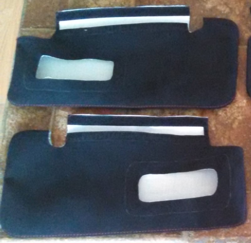

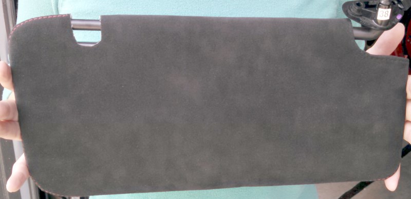

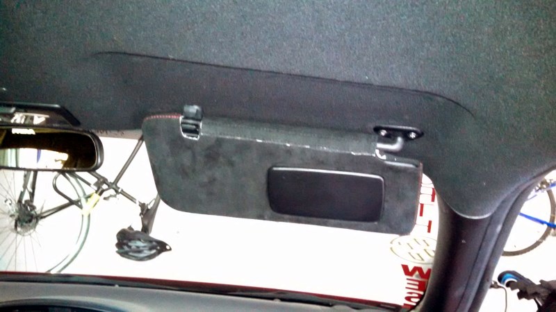

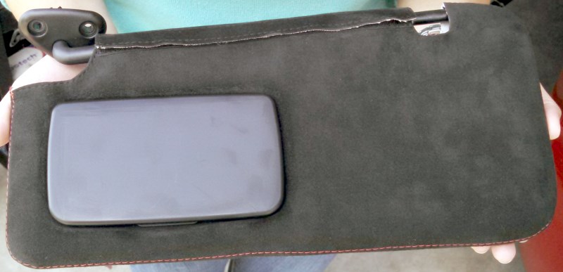

RedlineGoods sun visor black Alcantara with red stitching
I ordered @RedlineGoods Alcantara sun visors. I'm their first customer they are doing this for on a BRZ/FR-S. They've done many other car types, just not our cars yet for this particular item. I chose black Alcantara with a red stitching. The package came after 10 days. When I opened the well padded box it had the Alcantara fabric stitched and cut to just slide over the existing sun visors.
The install was straight forward. Remove the sun visors by taking out the two screws holding each up and unplug the wire for the light in the visor. The mirror pops out from the top. The Alcantara feels great on the hands. Since the fabric wasn't pre-installed I had to install it myself. Slipping the fabric over the visor took a little pulling to get it around the visor but went on and fit rather well. Some trimming was needed for the mirror to snap back into place. The drivers side hole for the mirror lined up well. The passenger side spot for the mirror was a little too far to the right but I was still able to line it up so it's not noticeable with the mirror cover closed. When the mirror cover is opened up however you'll notice the end of the fabric. Some slight modification is needed, which I'm sure they will do for the passenger side since I am their first try at the sun visors. It would have also been nice to not need to trim the mirror area for the clips to be able to go in when pushing the mirror in. The price they charge reflects the fact that you are getting the fabric piece only, not the whole sun visor assembly pre-wrapped.
As you'll see by the post install pictures, it looks very nice. Aside from the minor adjustment of the passenger side mirror hole, I would recommend they put some black stitching around where the plastic clip area that attaches/detaches for pivoting the visor, possibly folding in the fabric a little before stitching so the edge of the fabric isn't seen in that particular spot. They did this with black stitching around the metal pivot point assembly, so if they did the same for the plastic clip area that would be great.
The quality of the job is good and only needs a little adjustment before the product should be sold to the community (I was their first try). I would recommend @RedlineGoods to anyone looking for a less expensive, yet high quality alternative to all the other Alcantara sellers. Contact them on the forum here and check out all their offerings on their website as they are doing quite a few other parts now. http://redlinegoods.com/

Driveway Labs side skirts installed and painted gold.
Name:  Gold Side skirts.jpg

Installed the Mtec stainless steel brake lines with red rubber protective wrap. Install was straightforward thanks to this DIY from a fellow member. http://www.ft86club.com/forums/showthread.php?t=20311
The brake pedal feels a little less squishy now and more direct. Gives a little more confidence when braking. I'm on the OEM pads (I have separate track pads). The brake lines look cool as well. Picture below is of the rear brake line I installed.

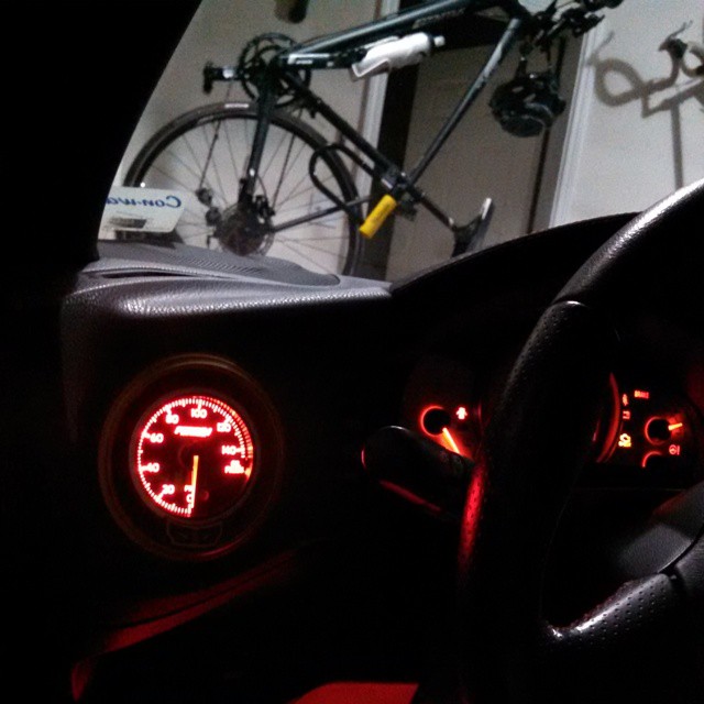

Installed the Perrin Shadow Gauge Professional 2 Oil Pressure Gauge in the ATI 60mm vent pod. I tried to install a ProSport oil pressure gauge but it didn't work right so Jeff at Perrin worked his wonderful customer service to get me this gauge instead. This one works great and has more features. Now I'll be able to tell if my oil pressure is at dangerous levels both on the street and on the track.
EDIT: My gauge does turn red!

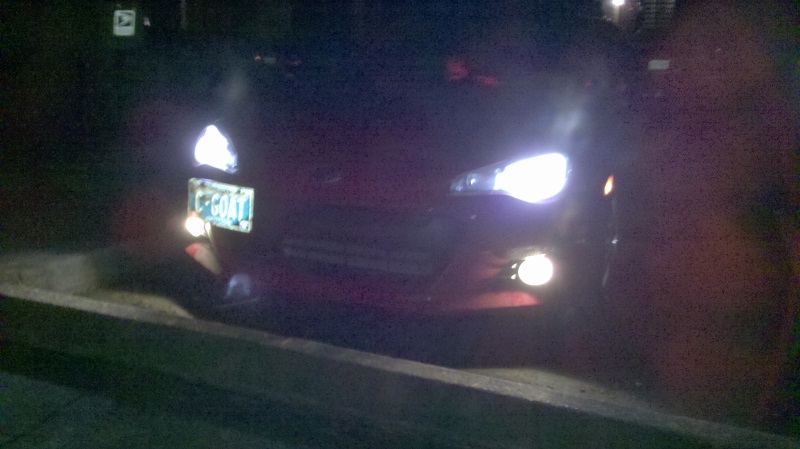

Installed the Diode Dynamics headlight L.E.D. boomerang always on kit/mod. Easy to install. Just remove a fuse and put the new one in and route the wires to each headlight. Plug the plugs into each side of the headlights. 10min job easy peasy. Now I don't need to turn on my light switch to accessory/drl mode every time. I can just leave it in auto mode and the boomerangs will stay on all the time. Plus the DRLs are adjustable so they aren't too bright when the headlights are on or you can switch it so they aren't on at all just like from the factory. With this setup you can have the headlights, DRL, boomerangs, and fog lights going all at once, which may look interesting. Main reason I got it was to make the boomerangs always on regardless of if the headlights turn on or not. The fact that the DRLs can dim and stay on when the headlights are on is just a bonus.
http://www.diodedynamics.com/store/l...-foglight.html

Painted the strut tower brace and the cross member braces crinkle red today.
Name:  Strut and xbar painted red.jpg

ROKBLOKZ mud flaps installed. As you can see there's almost no spray on the side panels. Only some water/mud on the very bottom that sprayed up from underneath.

Added lightness by adding Nameless Performance red aluminium ECU bracket and red aluminium pulley covers.
Name:  Namesless ECU and pulley covers.jpg

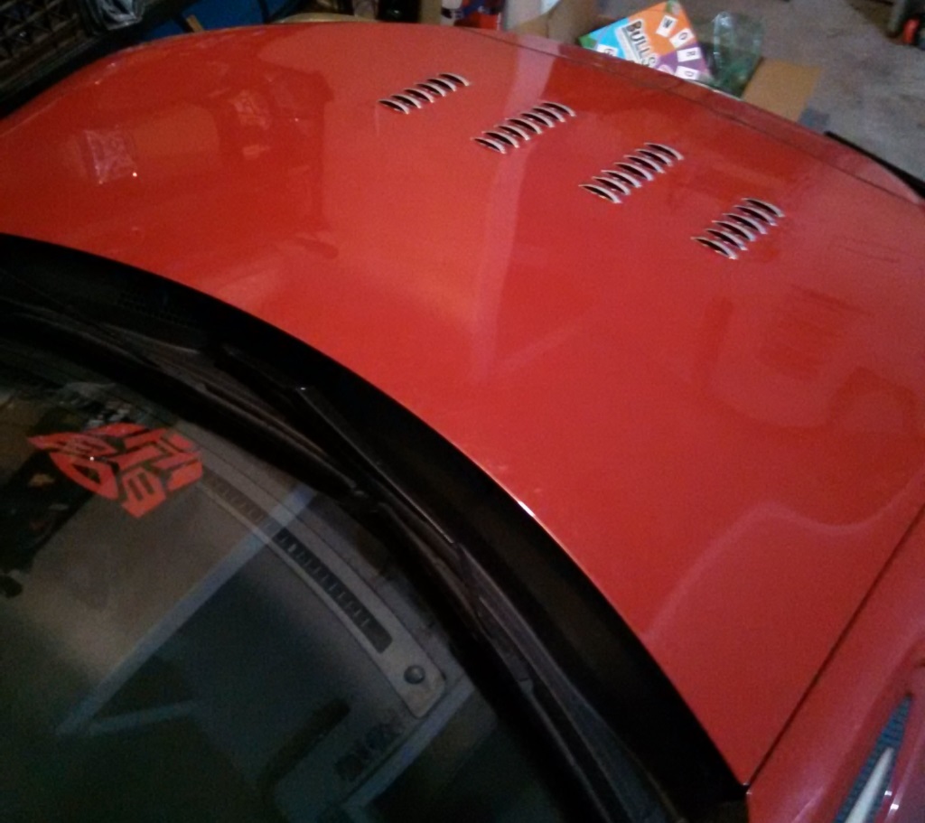

I had my hood louvered by Russ at Finish Line Coatings in Milwaukie. I have to repaint it still where the louvers were punched. Looks cool and different, like old school meets new school.

Painted the louver area on my hood yesterday. Turned out mediocre. I should have sanded down the existing paint that was left on the louver before as you can still see the red chipped paint even though it is painted over black. At least Plastidip is removable.

-Intec Carbon Fiber Tail Light with Clear Lens
-Verus Engineering Aggressive Rear Diffuser

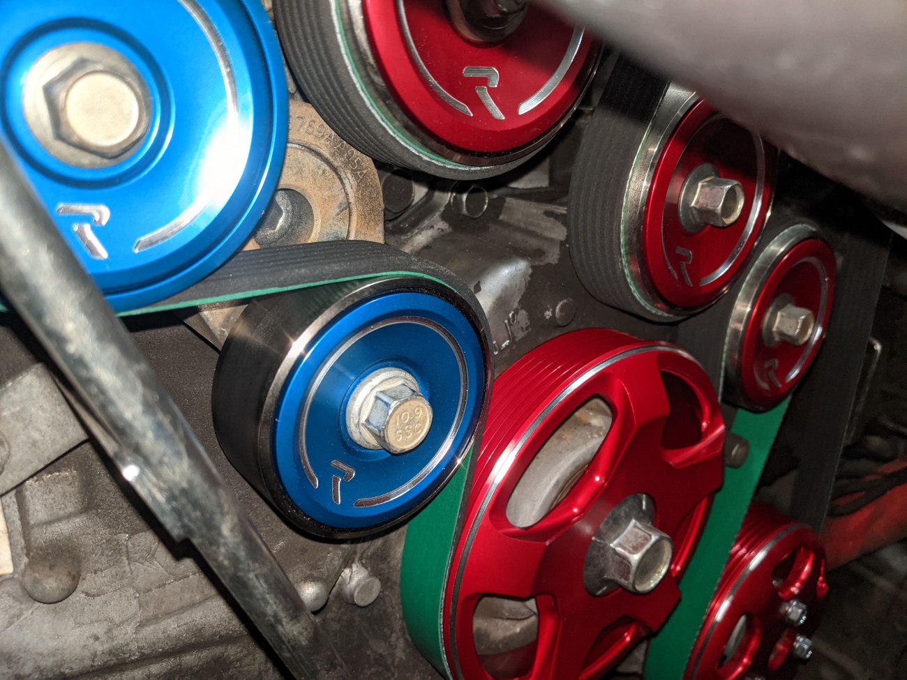

Installed all the RaceSeng pulleys with the exception of the alternator as I don't have an impact wrench to get the 24mm bolt loose and a breaker bar won't do it since the belt will just turn with it. I'll either buy a impact wrench or wait until I replace the alternator which should be in the next couple years since my car is 9 years old with 86k miles. I had to order a 2nd set of idler pulleys since I have an extra idler for the supercharger. I got red for all of them except the tensioner pulleys as sort of a way to add a different color plus show which are for tension.
Also installed a new belt while I was at it since the other was well over 2 years old and got the HD version for added strength/life, plus more colors for the upcoming holiday season (or something like that).

Nice ride dude! I'm diggin the transformer sticker. I was born in the 80's so I like all the retro stuff.
Hell whenever I finally get my ride I'll put a thundercats sticker on the same place as yours!
