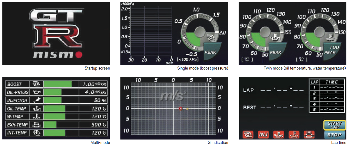

Finally an oil temp gauge that reads through the OBD2 connector.
Mounts in drivers side aircon vent but still allows the air flow
http://pivotjp.com/product/dual-gauge/img/DXW-e.pdf
