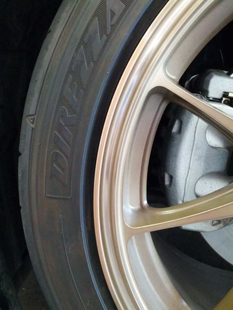

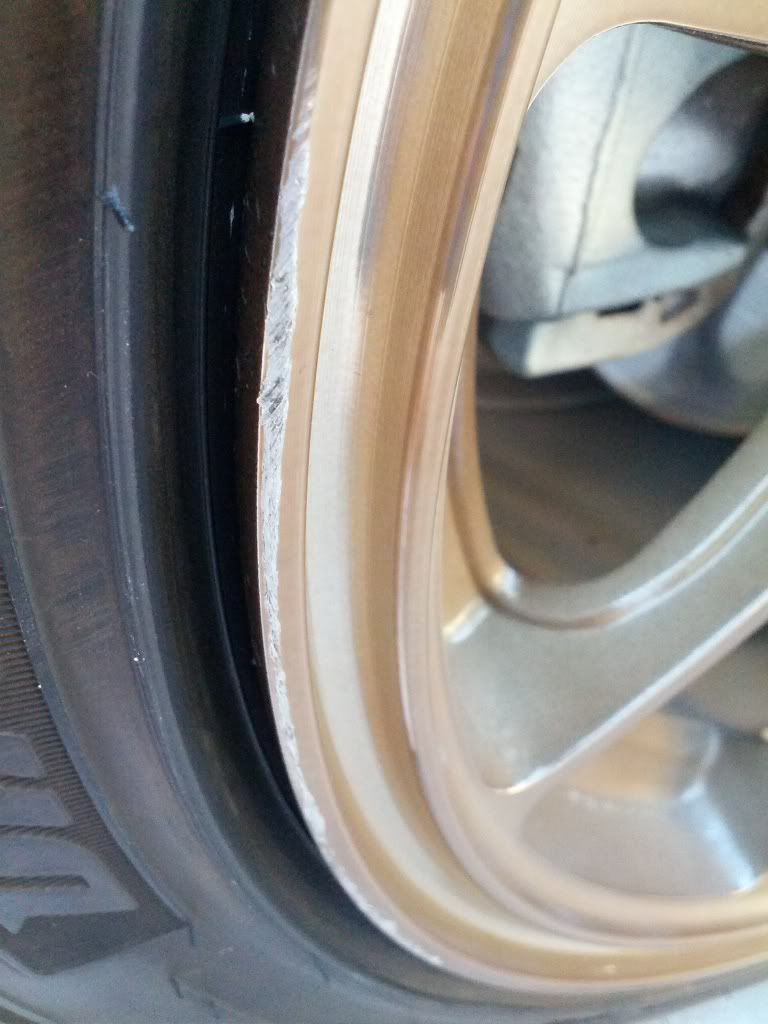

Rota Sports Bronze touch up paint
As Rota doesn't offer touch up paint in this color, has anyone found something close?
I curbed one of my Titans and a replacement wheel is unavailable right now.
So I cleaned it up with a Dremel tool and found a bronze Sharpie in my wife's crap. It came out pretty good but I'm searching for a better looking and more permanent solution. Unless someone has an extra wheel they can sell me!
Thank you.

Really nice clean up!

looks awesome, just leave it. had to do a double take to see what this thread was about. doubt anyone would notice unless you pointed it out.
Thank you!
I appreciate it. I might just leave it, spray some clear coat on and see how it holds up.

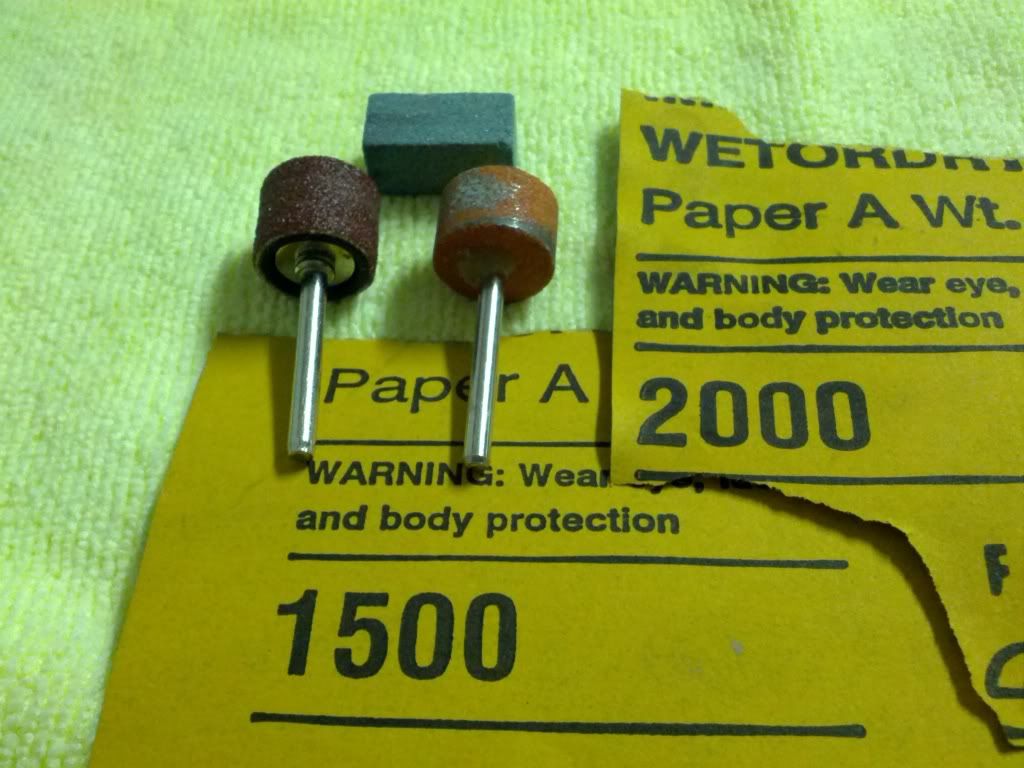

Originally Posted by Cjymiller View Post
I JUST did this in San Francisco the other day. Can you take a pic of the bit that you used with the dremel?
Here are the supplies I used. I had never used a rotorary tool before so these are probably not the correct bits or methods to use but it turned out well. I set the speed on the lowest setting and tried the sandpaper wheel first. It seemed too aggressive so the stone wheel is what I used for the rest of the job. When all the rash was ground down I used the honing stone to square up the lip. Then I wrapped some scrap pieces of wet sandpaper around the same honing stone to smooth out the finish. Aside from the difference in finsh color you cannot see or feel where the repair was. Good luck on yours!

@fstlane I've always wondered about using dremel tool on wheel. Outcome is great by the way, but wouldn't using dremel make uneven surface on wheel?
