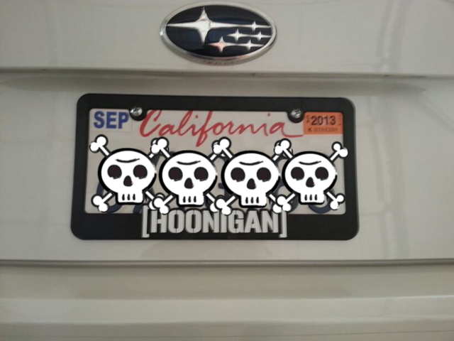

10-4-12 I installed my new license plate frame.

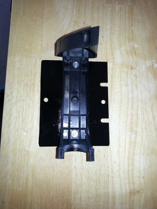

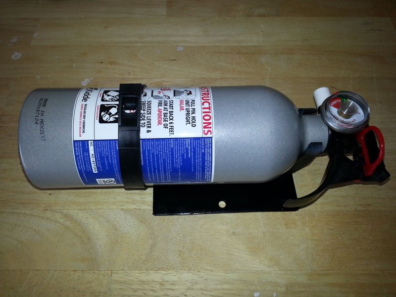

RazBRZ, thanks again for the idea.
10-2-12 Ran to Wallyworld and picked up a Kidde Auto Fire Extinguisher. Same dimensions as yours. Ran $14.00
I made a mounting plate out of 3/16" aluminum. 5" x 4.25". Drilled and countersunk for the extinguisher mount and drilled for the armrest bolts. I ended up using some longer bolts that I had to mount the plate.
Here's a couple more pics showing the plate with the bracket attached and showing the unit assembled.
Ignore the slots on the side of the bracket. This was scrap material I had laying around. In this case, it's part of a 3U panel blank for a computer rack.

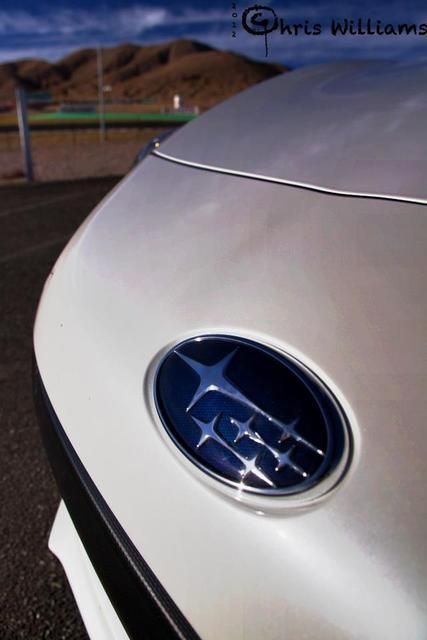

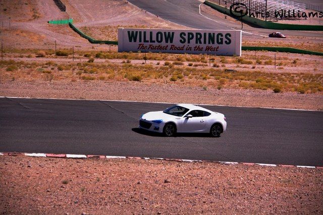

Willow Springs HPDE Sept 6-7. Had a great time. Galpin set up a really nice pit providing drinks, snacks and a place too relax.
I ended up driving about 120 track miles on Saturday and 90 track miles on Sunday. My best time was around 1:50 late saturday. Sunday I was driving slower and working on my lines.
A friend also came out and did some photography on Saturday. Chris with Chris Williams Photography.[/URL]

Oh nice willow springs, I'm stationed at Edwards AFB which is like down the road haha. I've got an asphalt frs and plan to take it to the track soon

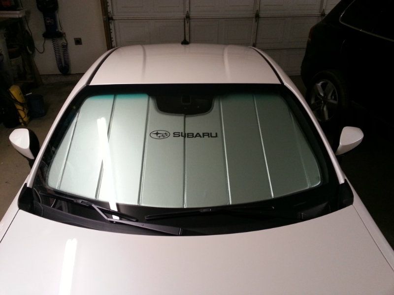

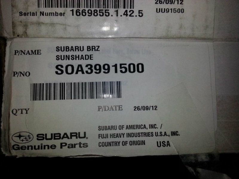

Got my Subaru sunshield yesterday.

Thanks I was wondering what the part # was for that sun shade

How much was that sunshade and where'd you end up buying?
Looks good!
