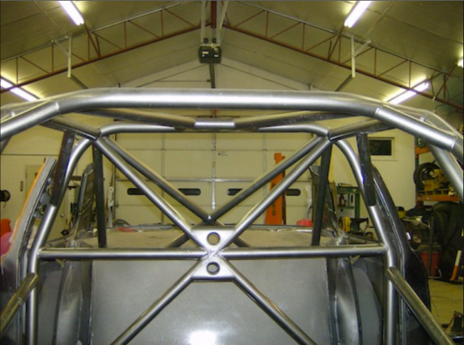

I am usually a fan of Cusco parts but those cages make no sense. To many bends. Also a six point is a very bad idea on the street unless you drive with a helmet all the time. Take that picture above of the A pillar bar. Your going to get pretty smashed up when you bang against that thing, knee's, face.
I've built a number of cages for numerous series, SCCA, BMWCCA, Rally America. I used to think it would be cool to have on the street but I really think twice about it now.
If your looking for a dual purpose car then the back seat is going to be useless and a welded in 4 point is the best bet. They often can be built for a very competitive price compared to the cost of buying and shipping a pre-made bolt in. And just welding in a bolt in cage is not what I'm talking about. Going with just a harness bar doesn't make sense to me, if you going fast enough and going to track often enough to need harnesses then you should be stepping up your safety. A harness bar offers no added protection in a roll over.
Look at this mustang, notice the feet of the bar punched through the floor. When a legit cage is made the cage is tied into the rocker panel which is much much stronger then the floor. Just think when you drill the holes for the bolt in's the drill go right through, how strong is that material.

This is 6 point built in my buddies bmw for Rally America, looks strong right. This photo was taken after the roof had been cut off because he had a terrible wreck. End over end, barrell roll. The car was a complete write off. Cage looks brand new.
