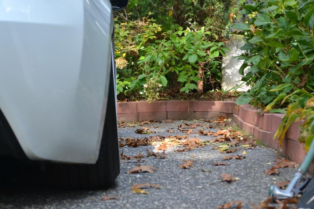

here are mines
17x9 et35 on michelin stock 215/45

BRZfan's Avatar
Drives: 2013BRZ Premium St Silver Metallic
Location: USA
Posts: 824
Thanks: 79
Thanked 212 Times in 156 Posts
It would be best for you to stop in and talk with the Tire Rack people. They are the professionals, day in and day out.

looks good^
