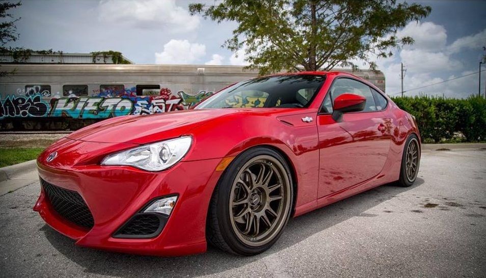

Originally Posted by HuntingtonFRS View Post
Hello everyone. I could really use some advice.
Picking up these wheels:
COSMIS RACING XT-206R BRONZE 18X9 +33MM 5X100
Not sure what tire to get. I want performance over stance. I don't want to stretch the tires and I don't want to poke beyond the fenders. I do have Tein Flex Z coil overs but I'm lowered about as much as the TRD springs take it.
Please guide me oh wise ones!
18x9 +33 is roughly equal(outside width) to 18x 9.5 +39(38/40 is 1mm difference), so look up other setups and see how they fit and decide if you are ok with that look.
245/35 is a good tire size. Look up the specific tire and see the recommended rim width and the tread width to see how they should fit.
Camber/height/alignment would affect how they would fit.
I say the are a very good choice overall, not too wide, not too stancy pants, but not sunken in either.
Quick google search got me this pic. Looks good.
Be aware that you will be lowered less and will probably have less camber, so it may poke out at the top of the wheel slightly more.
Yeah, I spoke to the owner of that car. He ran 225/40/18 which just seems insane to me. That would be crazy stretched would it not?
I wouldn't call it a crazy stretch, but still stretched quite a bit at around ~2 inches or so. I ran a 225/40 on a 9.5 rim. Exposes rim/sidewall to get damaged more easily. The rims all had rock chips all around. I probably won't do it again.
