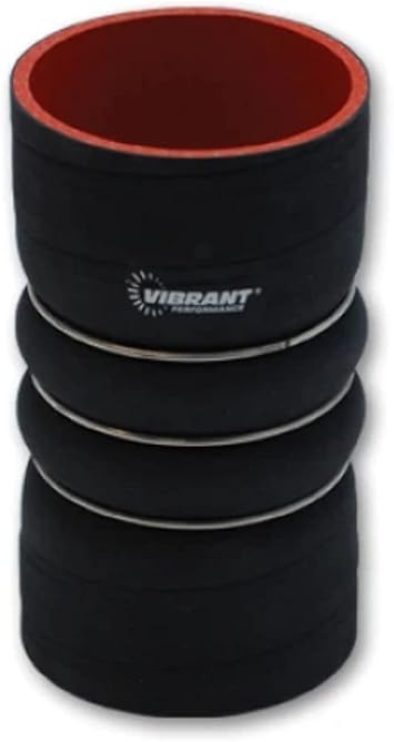

The Vibrant HD clamps allow a lot of movement, possibly even more than silicone. Watch this video, at around 5:20 they show the freedom of movement in 2 places.
I bought the Epman clamps off Aliexpress for my build, the full set cost the same as one Vibrant clamp.
Follow me on Instagram: @brzdiy
I’ll consider the clamps. I think the Vibrant clamps are overpriced like many products sold to Americans that are probably produced in China, but I also heard the tolerances on the o-rings or the use of materials on the Chinese ones can sometimes be cheap to such a degree that there are boost leaks. If you say these ones are good then I may give them a try.
Silicone couplers allow a lot more movement, but these actually look pretty good, so thanks for the video. I know they say 12% ROM, but I didn’t think it would be that much. Considering he used only two clamps at either end, that was decent movement.

I normally avoid Chinese knockoff products to be honest but the way I see it with these clamping systems they are all just small variations of the original Adel Wiggins design yet they still want to charge you a fortune for what is essentially a copy.
I watched the video below and thought I'd give them a go. I have received the clamps and visually the quality looks excellent. Obviously my car is not running yet but I doubt I will have a problem with the low-ish boost pressures I plan to run with my Honda engine.
I’m not opposed to having Chinese knockoffs. My turbo, wastegate, BOV are all Chinese knockoffs, but still good quality. I just need reviews or a video like this to confirm the quality is there, so thanks. I’ll consider these.
I’ll would still have a silicone coupler on the intake box. I’d need an expander 90 elbow for the turbo outlet from 2” to 2.5”. I’ll maybe need a 45 elbow off the throttle body. I would need to sand the powdercoat off the ends of the intercooler to mount the clamps, and then I will need 3” to 2.5” reducers.
Silicone couplers would be adequate, but this would be unnecessarily better. Still, it is more appealing. I might have to pit an elbow on the throttle body to clear the airbox, so I might as well make it clean.
You can buy 6 of these plus the shipping cost for the price of one vibrant clamp. Which makes them very enticing
