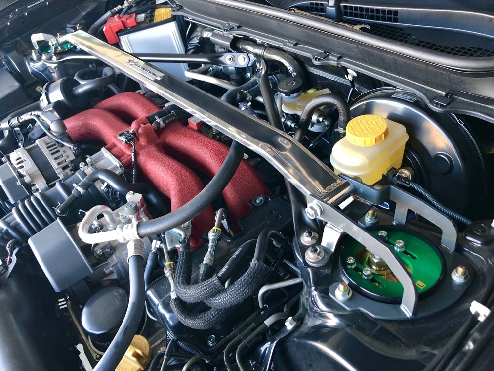

Has anyone test fit a strut tower brace yet? Looks like maybe Cusco, Whiteline, Megan, etc. style may clear but figured I'd ask before buying and wasting money.
I have a Blitz model. If you can hold off on waiting, I'll let you know if it fits sometime in early to mid December.
