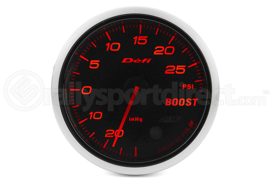

I think I figured something out. I did an idle log. I have never done one. I did it just to see what my MAP at idle shows to compare to yours, and it shows 0.32 bar, which is 0.68 bar below atmospheric or 9.86 psi of vacuum, but my gauge showed roughly 20 psi of vacuum. See the log below where I tried to replicate your startup logs, which was a warm start--not a cold start (this is a custom tune on E85, just FYI):
https://datazap.me/u/jirace/test-com...0&data=8-25-29
Honestly, I am not a tuner, so I am lost on why the log doesn't show more vacuum. My gauge is accurate. I know ECUTEK has limits on boost (or at least 19 psi was all it could log), but I don't know if it has limits on low MAP values too or what. In short, maybe the MAP is fine on your logs.
I'm honestly kind of lost. We can't compare fuel tables because of my 770cc port injectors and E85.
Going back to your trouble codes, it said the direct injectors in bank 1 were faulty and you got a lean condition. I don't know if one of your direct injectors failed causing a lean situation, or if your direct injector seals failed, but the latter could introduce unmetered air under piston expansion and could result in a poor idle because of compression loss. Outside of that and a bad o2 sensor or crack in your manifold, I just don't know man. I need to hand this one over to someone more knowledgeable.
@tomm.brz
@steve99
What is normal guys? Should his atmospheric pressure be 1.0 if he is at 5000 feet. Mine is 1.01 and stays there. My MAP starts at 1.01 and goes down. His starts at 0.88 and goes down, but his atmospheric pressure says 1.0. Why doesn't our logs indicate more vacuum at idle? My gauge says 20 psi of vacuum, but my idle log says like 9 psi. I know the gauge is accurate.
raw manifold pressure should be aprox 1 bar with ignition on but engine stopped.
when engine at idle manifold pressure should ve about 0.4 bar
if it doesnt move you likely have intake leak or map sensor is bad
i think your guage might be reading incorrectly
you pi\di ratio seem very odd seems to be 0 to 100%
can you screenshot the pi\di tables

No. The gauge works. My brain doesn’t
I’m feeling particularly stupid lately. Apparently I can’t read my own gauge. PSI up top and inHg for vacuum. I was suggesting my idle vacuum was 20 psi , but it is 20 inHg, which is 9.8 psi of vacuum or 0.32 in absolute bar.
My car runs perfect. My post was a comparison to help him, but I’m butchering things, so I’m going to bow out.
I wouldn't be too hard on myself. If it's a common thing to switch unit systems at the zero crossing, that's a terrible design; especially without any other obvious visual cues.

It seems you are making plenty of vacuum, now that someone has oriented my brain to inHg values. You are making boost too.
