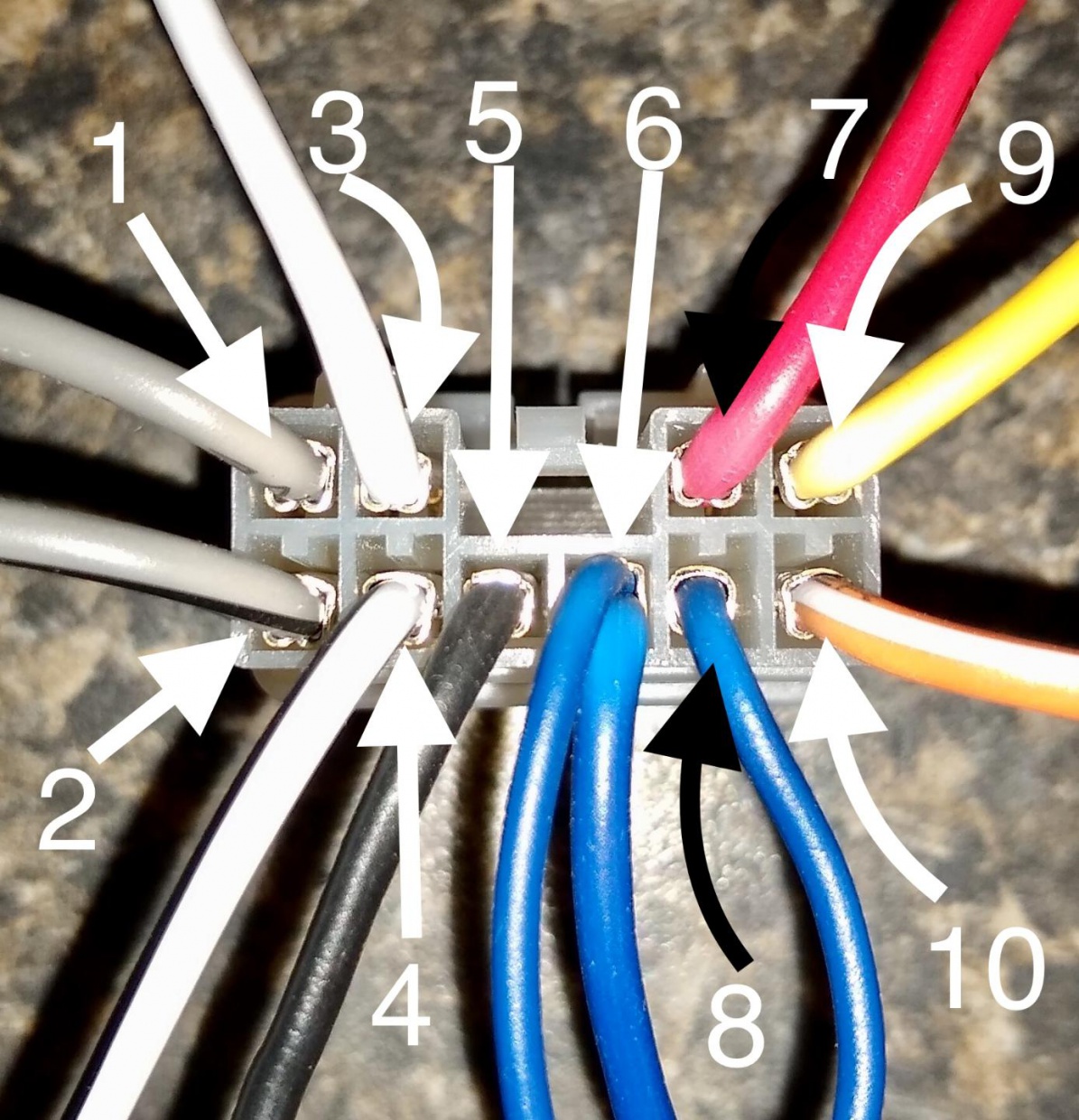

Originally Posted by FR-S2GT86 View Post
Needed in reference to what? In building an amp bypass plug or for installing a head unit in the dash?
In building the amp bypass plug for the 2020 head unit swap.
blazephantom is offline   Reply With Quote
Old 06-11-2021, 05:53 PM   #103
FR-S2GT86
Master Collaborator
FR-S2GT86's Avatar
Join Date: Nov 2019
Drives: Was '15 FR-S, 6MT, Now '15 GT86
Location: West Virginia, USA
Posts: 1,394
Thanks: 208
Thanked 985 Times in 597 Posts
If you're simply building a bypass plug out of a Metra harness, then look at this diagram here,
Jumper pin positions:
#1 and #7,
#2 and #8,
#3 and #9,
#4 and #10,
Remove pins from all other positions.
