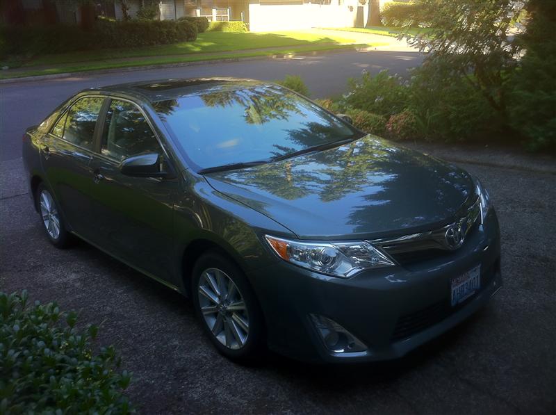

Originally Posted by travace View Post
Wish me luck everyone. hope i get my FRS back sooner then later... this Xd sucks. i feel like im sitting on top of a stack of crates in this thing.
I'll trade you:
On the bright side, I can tell you that the FR-S/BRZ is not the only car with rattles. This is a current Camry with only 4,000 miles and it has some true doozies in it.
My FR-S has been in the shop for a few hours now. No word, yet.
