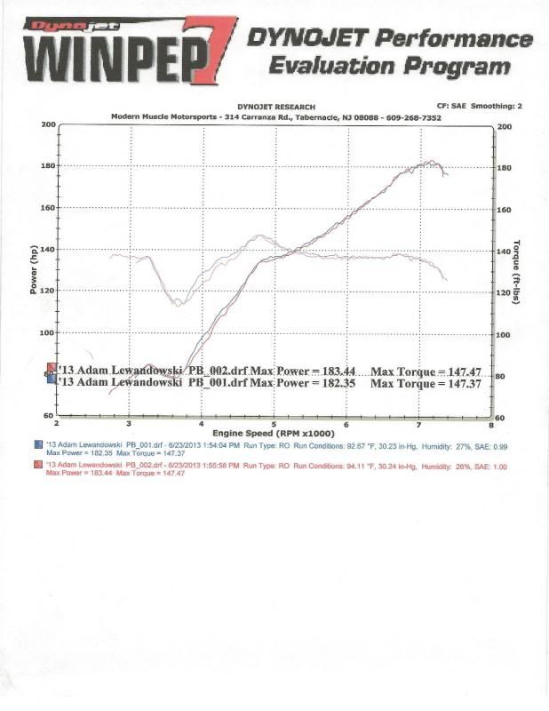

Mobile dyno at a local car show with not the best conditions but I was curious as to where the car was at. My mods are a Perrin CAI with Perrin silicone tube, TRD cat-back and a Visconti Stg.1 pumpgas tune on 93 octane.

Those aren't bad numbers. You need a header and stage2 to cure that dip.
