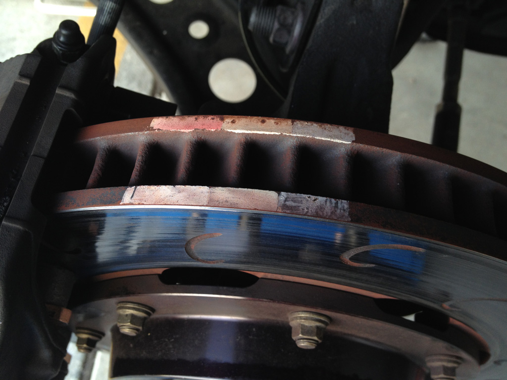

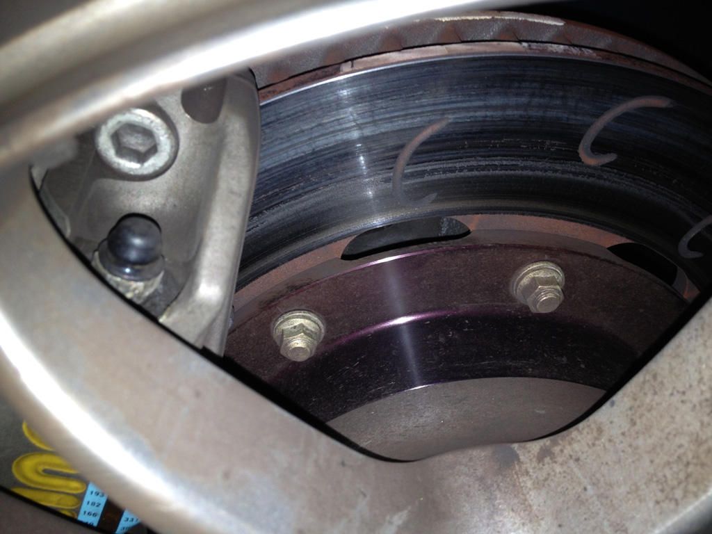

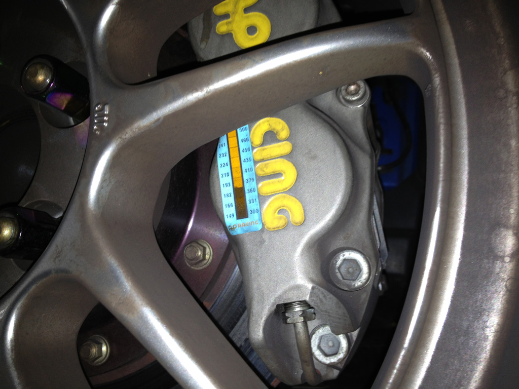

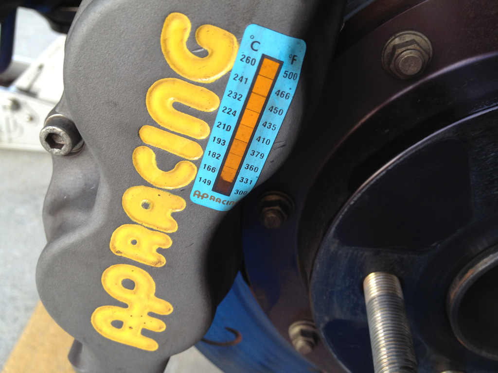

Here's some current pics of mine, with rotor temp paint and caliper temp strips...
This past weekend I was at Sebring, saturday running AP C300s up front and Sunday running CL RC6E's up front.
First four pics are from saturday, so post 2 hours of usage on the track with AP C300s up front.
Driver side rotor temp paint/rotor:
Driver side caliper temp strip:
Pass side rotor temp paint/rotor:
Pass side caliper temp strip:

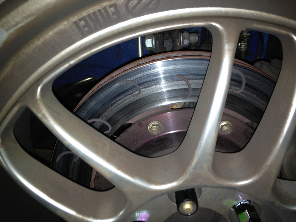

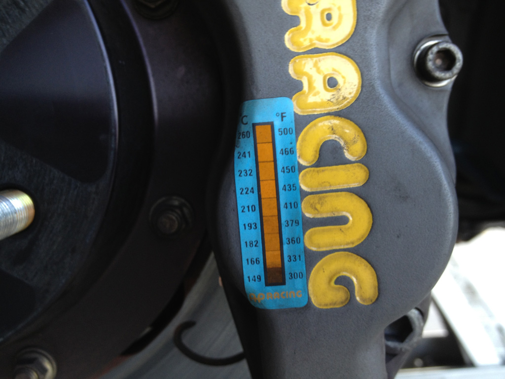

The next four pics of from this morning, about 1.5 hours on the track Sunday with CL RC6E plus street driving on CL RC6E pads. I haven't taken the wheels back off yet so I'll update with better pics when I swap back to AP S100 street pads.
Pass side rotor:
I was late braking more with the CL's to try to overheat them. I failed. I did get the calipers a bit more toasty though I didn't really bed them in much either, didn't have time.

Nice Dave...beat 'em up! :happy0180: You definitely got them good and toasty with the CL's. The CL's do tend to run a little hotter anyway, since they are sintered metal.

Dave can you outline the usage of the temperature paint? Is each segment applied before a particular session? I assume it is the Genesis Technologies stuff?
http://www.essexparts.com/brake-disc-thermal-paint.html
I'm using AP Racing thermal paint. This was applied before the weekend, I didn't care so much about each session vs the max I could reach over the weekend. I hit 1,130°F on the outside facing rotor face within one real session. Not sure if the inners hit it or not, last check they didn't but I was harder on the brakes Sunday and I haven't pulled the wheels off to check yet.
