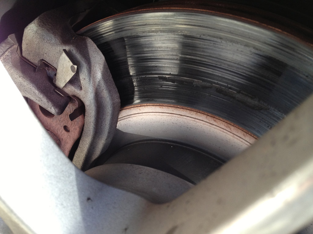

So yesterday was fun at Sebring.. my front brakes.. yeah they are hating life.
All day by around 20-25 minutes into the session I'd start getting pad fade, no big deal since the OEM front brakes are going soon anyways.
Well from 4-5 they do happy hour, which is open to all groups so I went out for about 40-45 minutes of that session. Brakes felt great (well as great as they did before anyways) and afterwards I went for a 15 minute cooldown run around the paddock (technically the rig/trailer parking area at Sebring). After that I went back to the normal paddock and hit the brakes at a stop sign. Pedal went to the floor. DOH! Pumped them 3 or 4 times and they came back.. and then immediately faded again.. ugh. Parked and checked for leaks, no leaks but the drivers side brakes were still smoking pretty badly. Drove it around for another 15 minutes or so and the pedal was firm again (more or less) and kept pressure.
So I can't wait to get some new front brakes in Current setup is Carbotech XP10 pads, ATE super blue, OEM rotors and calipers. New setup is the Essex Sprint kit.
My driving at this event (not that great) is partly to blame. I was braking too much after losing confidence with the pad fade earlier which just makes it worse. Also I need to switch how I heel toe, I'm used to my race car which has a much larger spread so occasionally I was on the gas and brake. Oops.
Pic of the drivers side rotor/pad/caliper (sorta) this morning:
-Dave
Dayuum! Is that rotor has meat missing? Or pad's meat is stuck on the rotor?
I actually only noticed that in the pic. I haven't gone out to check. Hopefully just pad or I'll have to replace the rotors instead of returning my spares..
Yeah, you don't wanna chance it driving w broken rotor

Just went out and checked, they aren't holes... they are dull gray areas instead of shiny metal. I'd replace the rotors if I had any intention of using them for awile but I'd rather get the 120-130 or whatever the spares cost from NAPA back
