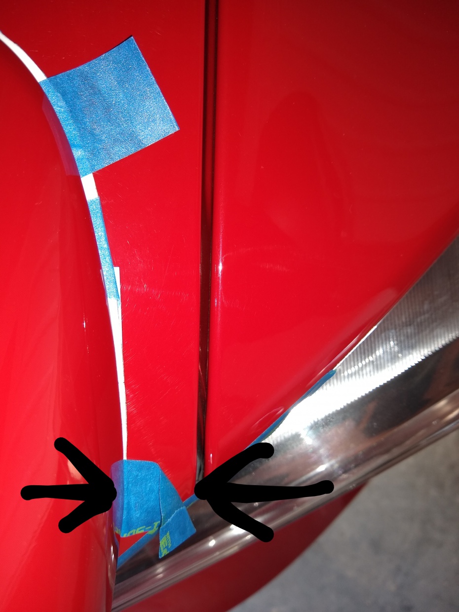

Alright, as I compare your tape measure pictures to mine at just about the same angle that you snapped your pictures,
it would appear as if I need to begin grinding out the forward stud hole towards the passenger side a little bit to result in about a half inch of movement from the forward "point" of the risor base in the direction of the trunk lid edge.
The rearward stud hole looks to be in the perfect position.

Not sure it's the same angle but did the best I could
ThatYeti is offline   Reply With Quote
Looks like a 7/16" difference between your forward measurement and mine, which I estimated pretty close using the tape measure at 1/2".
Thanks for your help.
