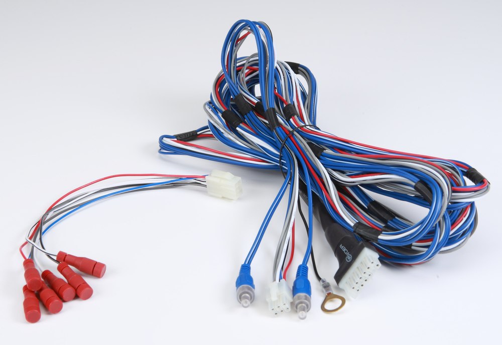

The Posi-Tap connectors on my harness are black.

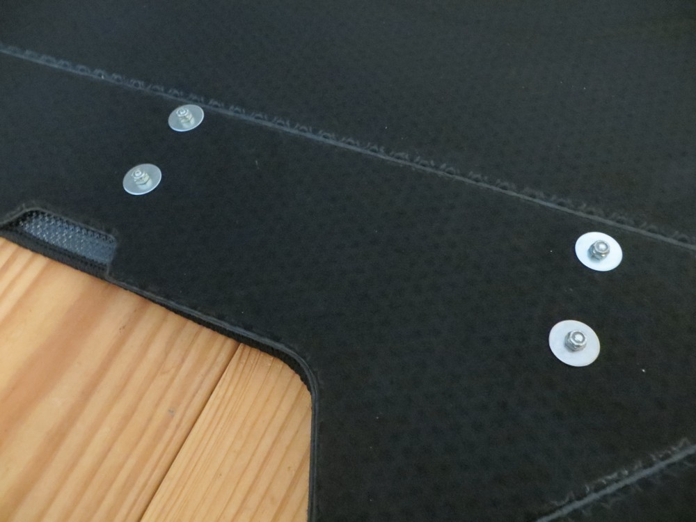

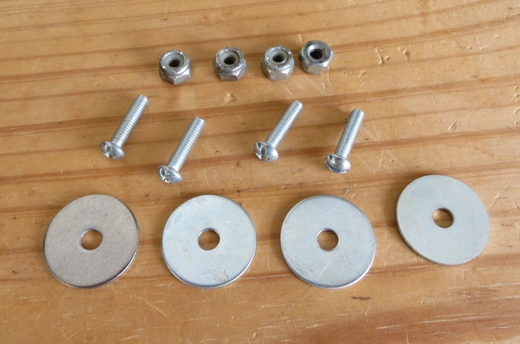

I mounted the sub on the passenger side of the trunk by securing the mounting bases to the trunk carpet and trunk mat using:
4 - #8-32 nylock nuts
4 - #8-32 x 3/4” machine screws (use 1/2” or 5/8” if only trunk mat, no carpet)
4 - 3/16” x 1” fender washers
You can purchase these separately at Ace Hardware.
You could also use zip ties, or if you only have a trunk mat industrial strength Velcro.

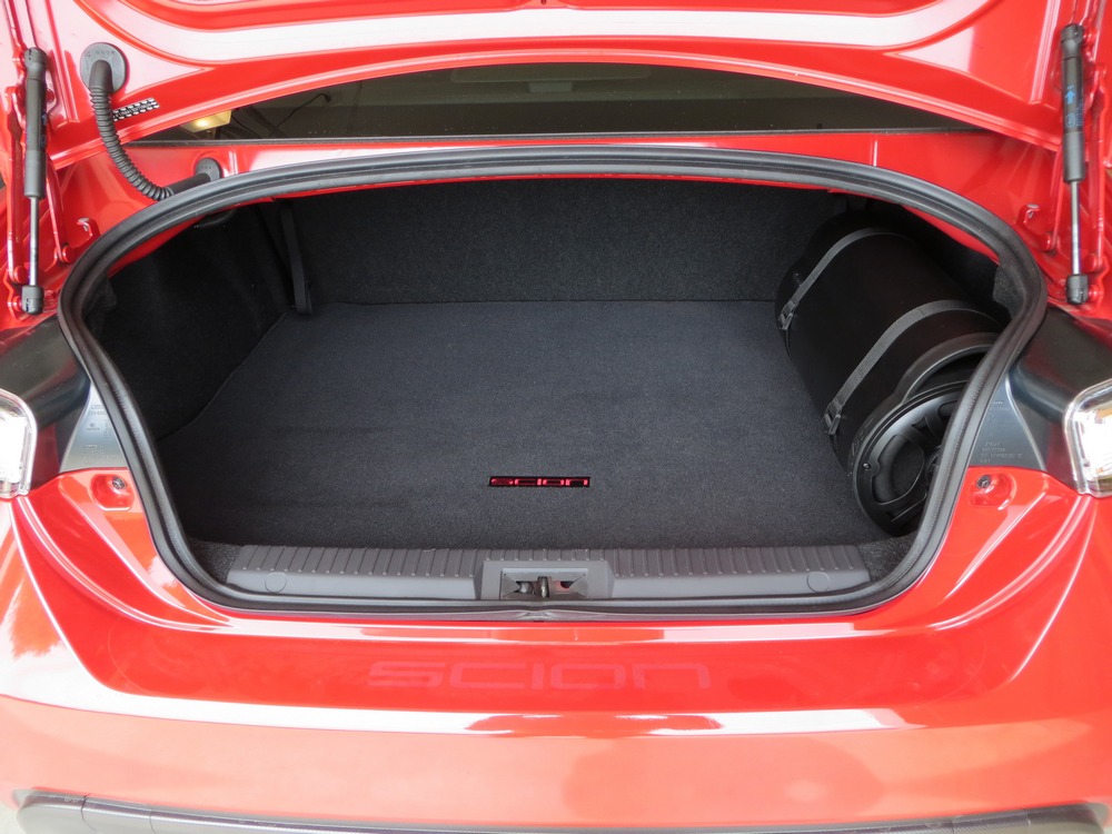

I placed the sub as far back as it would go so the back panel would help keep it in place while still keeping Bazooka’s recommended 2 – 4” between the woofer and the corner it’s pointing into.

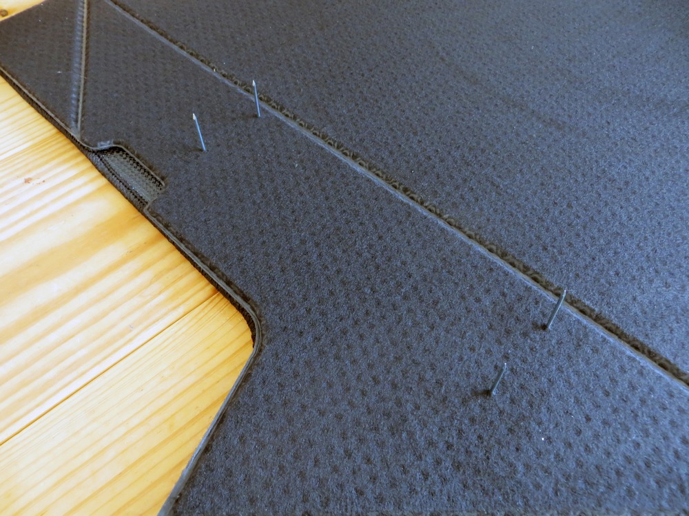

I positioned the mounting bases ~3” from each end of the sub and used finishing nails to mark the spots for the screws.

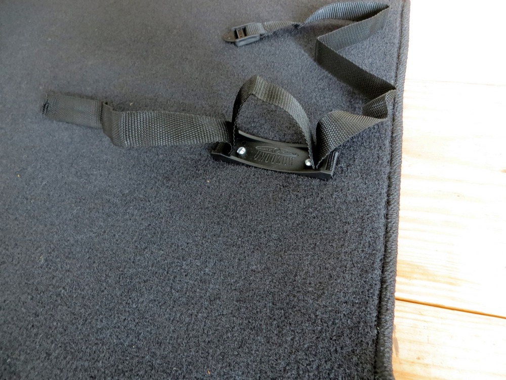

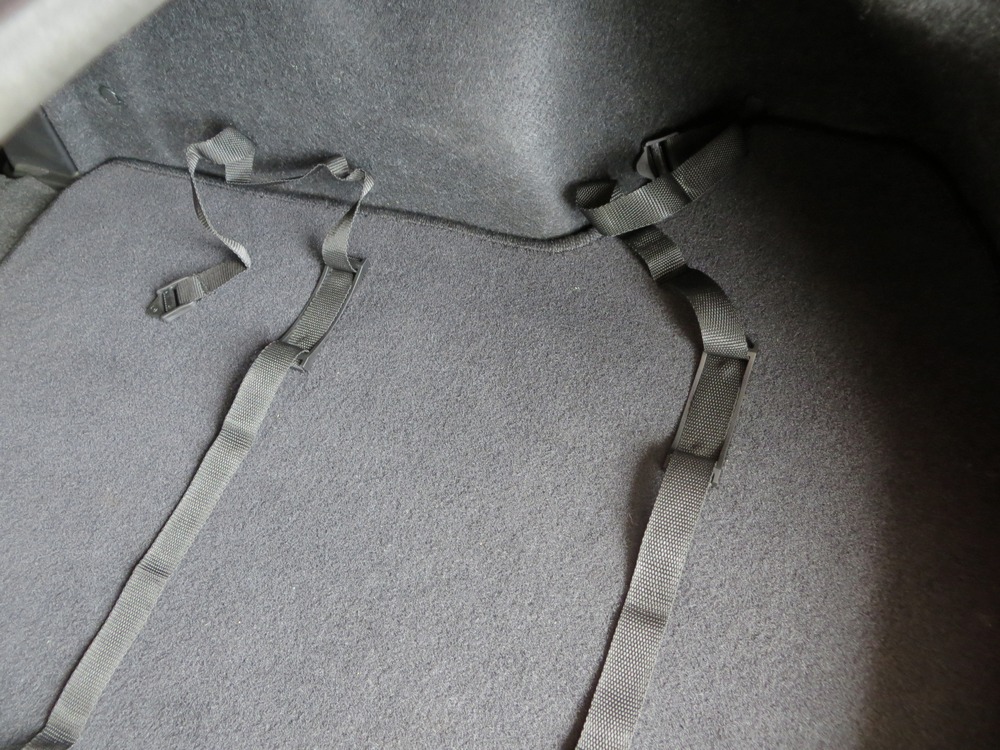

If you remove the straps from the mounting bases re-install them before securing them.
On page 9 of their manual they suggest for their 8” model 22” for the length of the buckle end side of the strap but I found that ~19” works better.

Connect the 6 Posi-Tap connectors on the FAST-9999 harness to the corresponding wires on the 10 pin plug. Be careful not to cross thread them.
Battery Constant 12V+ wire: Red
Accessory Switched 12V+ wire: Blue/White
Left Front Speaker wire (+): White
Left Front Speaker wire (-): White/Black
Right Front Speaker wire (+): Gray
Right Front Speaker wire (-): Gray/Black

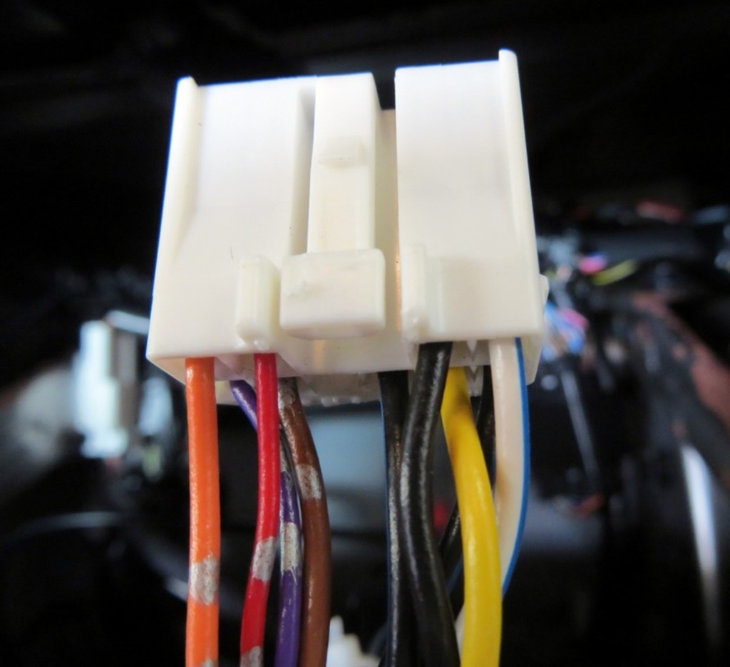

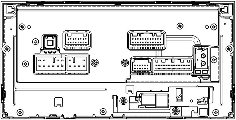

Back of PT546-00140 HU, 10 pin plug is on lower left.
10 pin plug wires: pin numbers read top right to left and then bottom right to left.
Battery Constant 12V+ Wire: Orange - pin 4
Accessory Switched 12V+ Wire: Black/Blue - pin 3
Got this info from 2 different sources but on my 2013 FRS this wire is Red.
Left Front Speaker Positive Wire (+): Black - pin 2
Left Front Speaker Negative Wire (-): Yellow - pin 6
Right Front Speaker Positive Wire (+): White/Blue - pin 1
Right Front Speaker Negative Wire (-): Black/Blue - pin 5
Ground: Black/Blue – pin 7
Illumination: Purple – pin 10
Factory Amp Turn On: Brown – pin 9
My accessory 12V switched wire, pin 3, is Red not Black/Blue.

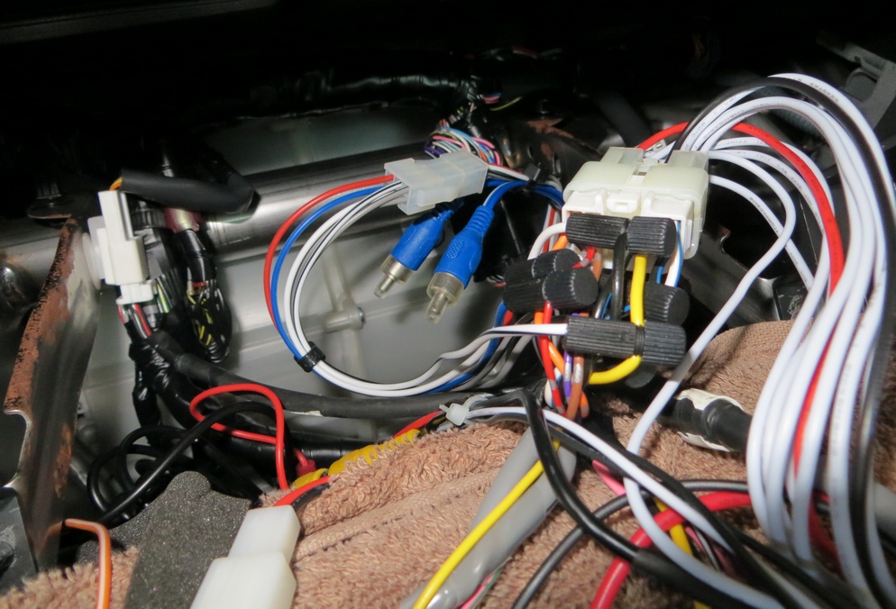

I have an Auto Harness House back up camera harness so my 10 pin plug connects to it.
I should have cut the electrical tape wrap back more on the 10 pin plug cable to give me more room to connect the Posi-Tap connectors.
I would have connected the FAST-9999 harness to the Auto Harness House harness but the wires were too thick for the Posi-Tap connectors.

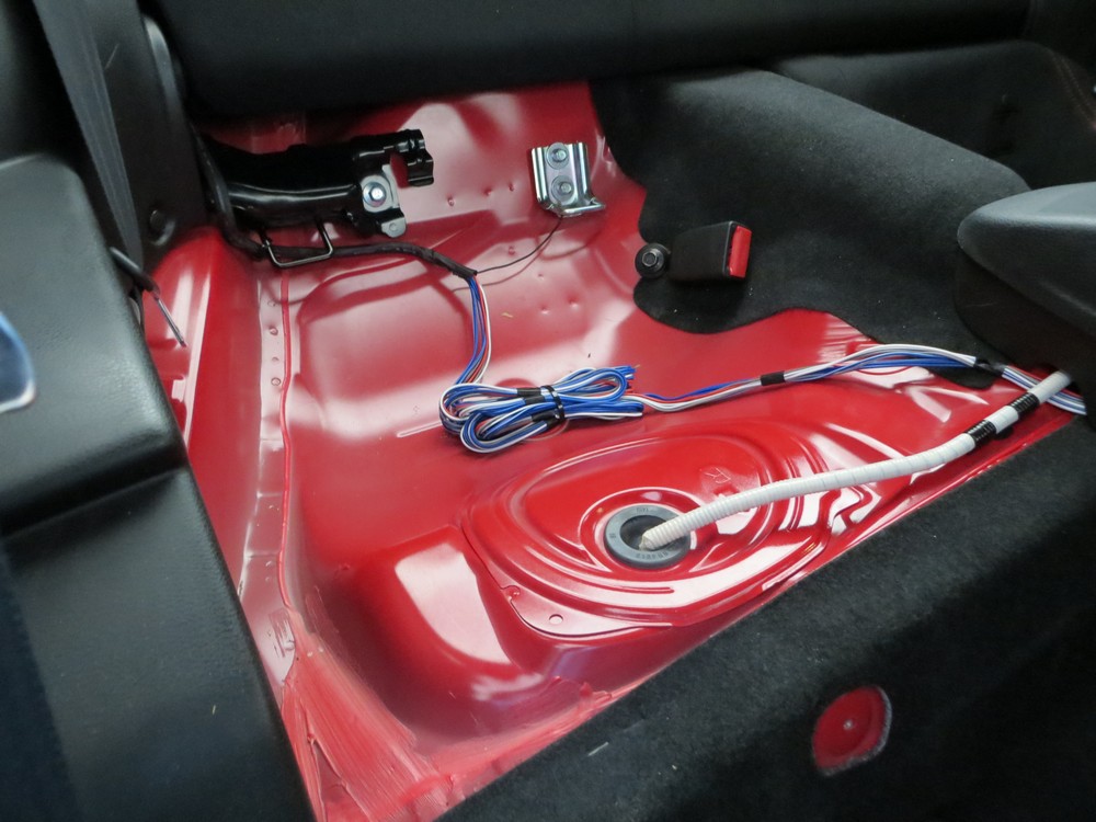

I routed the FAST-BTAH cable under the bottom of the rear seat, tucked it under the right center console panels and the right knee pad, and then up to the HU. It makes it a bit easier if you remove the glove box.
I attached the ground wire to one of the back seat bracket bolts and zip tied the excess cable under the rear seat bottom.

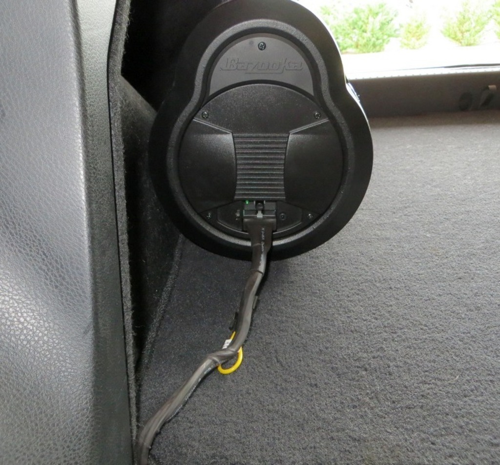

Connect the 14 pin connector on the FAST-BTAH harness to the bass tube.
Turn your key on to accessory, turn your radio on, check that the green led power light on the sub is on. Play some music to check if the sub is working.

With the sub in the corner I still have a fair amount of trunk space left. I can easily unstrap, unplug the sub, and remove the trunk carpet and mat as one piece.
