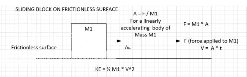

Sorry, but it makes perfect sense if you understand physics.
Consider this diagram:
Force = Mass X Acceleration. or A = F/M
If you do an experiment with mass = 1kg and apply a force of 1 Newton, you get an acceleration of 1 m/s^2
If you reduce the mass to .7 kg but apply the same force you get more acceleration:
A = 1/0.7 = 1.42 m/s^2
So with the same force, the object accelerated more because it was lighter
So we can look at your statement again "So you accept that a car with a lighter pulley in reality revs faster, but you don't accept that it makes more power. This doesn't make sense."
I will break it down:
"So you accept that a car with a lighter pulley in reality revs faster" - Yes.
"but you don't accept that it makes more power" - No
However the rotating mass is less and the engine has exactly the same power so it will rev faster
