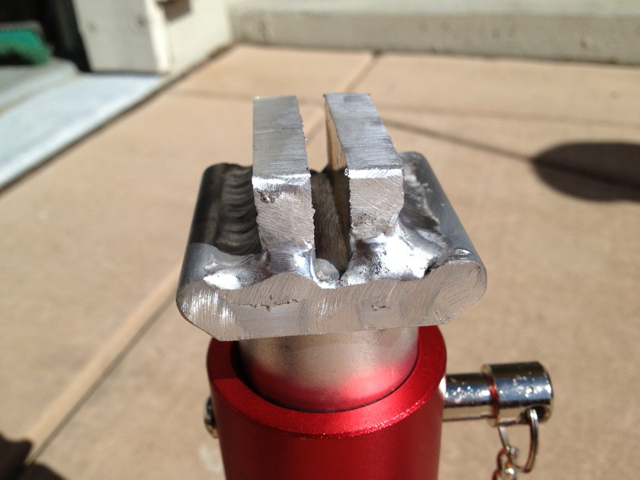

Just changed my jack stands. Welded on some pieces to help support the car without bending the crimp spots. Attachment 70750Attachment 70751
AT LAST, thank you @DrDruquette someone with a satisfactory design for a jackstand pad.
After reading this thread and following most of the links I am afraid that a lot of people are putting themselves and their cars at RISK. Just because something works once, twice or a dozen times does not make it safe.
The seam weld is not meant to support the car. As far as I can deduce the actual jack point is INSIDE of the seam. If you look at the OEM jack you will see that the slot in the top is deeper than the height of the seam - no load on the seam when supporting the car. You will also see that the slot in the OEM jack is offset. When in place notice that the outer (narrower) part of the pad does not contact the car. All of the weight of the car is resting on the inner (wider) part of the pad.
@DrDruquette I would suggest a modification to your design, the slot should be offset and the cheek on the inside of the seam should be at least 1 inch wide. The center of the larger cheek should be on the center-line of the jackstand.
