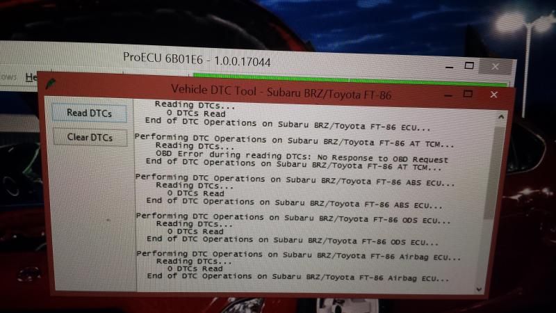

Here is a screen shot of what I am getting...
also seem to have lost my 2 step. I have reloaded the tune.
Having idle issues and startup issues.

Check the fuse for obd port
Check you obd socket/plug that no pins bent or pushed back into socket in car.
See if another obd device such as scanner will talk to obd port.
I gather the car starts and runs ??

Can you reflash a known working tune ??
If the previous tune was ok then it might be some other hardware issue.
If your boosted a few guys have had cats disintergrate and block exhaust causing weird issues.

Do you have a good connection at the OBD-II port?
Also what version of windows are you running?

Good thing to note, but we have a Dell Pro 8 Tablet and it works fine. But we will keep an eye on that, as it is a good point. But I believe the cable is powered by the OBD-II port itself anyways.
Can you connect and reprogram or even do live data connect?

Well I am speaking to EcuTeK about the DTC check, as I have had a couple other people have a connection issue with OBD-II DTC's.
You can also use the feature under programming ECU, as we have found this works a little better. Try that and see if that works better.

please tell ecutek after flashing i have some DTC error ?!!!!

I get the same thing. My screen look like that one.
