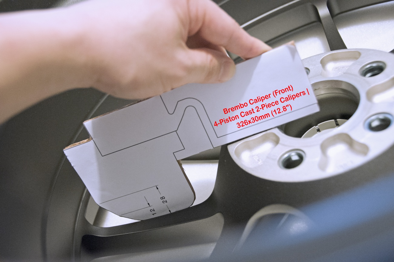

Brembo GT/PP Caliper Clearance (BBS STi Performance Wheels)
I took the liberty to print out the templates for the Brembo Calipers to check clearance/rubbing issues for those who are thinking of getting the wheels. I could be wrong on the template placement in the photos, but I've double-checked everything for the front & rear. The rear calipers will clear no problem, but the front calipers manage to hit the spokes by 2-3mm. Assuming 5mm-10mm spacers in the front will clear no problem. If these were made for the stock calipers, perhaps Subaru will make the same wheels 18x7.5 +40 for the Brembo Performance Package in the possible future?

Can you please tell me where you got this template from?
Front:
http://www.racetechnologies.com/site.../1H4.6005A.pdf
Rear:
http://www.racetechnologies.com/site.../2E4.5003A.pdf
