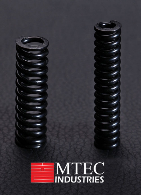

Swapped in the MTEC clutch spring tonight. That was a surprising PITA for something that looked so simple! Pleased with the result, though. Pedal feels like it should have all along, and somehow the throw feels shorter?
That spring makes a big difference, it's impressive how much. You can adjust where your clutch engages, there's plenty of DIY posts here.
The next step is to install the shift spring kit. These springs really improve the shifter feel.

Edit agreed about the mtec clutch spring. That was the first mod I did. I ordered it before I took delivery.
