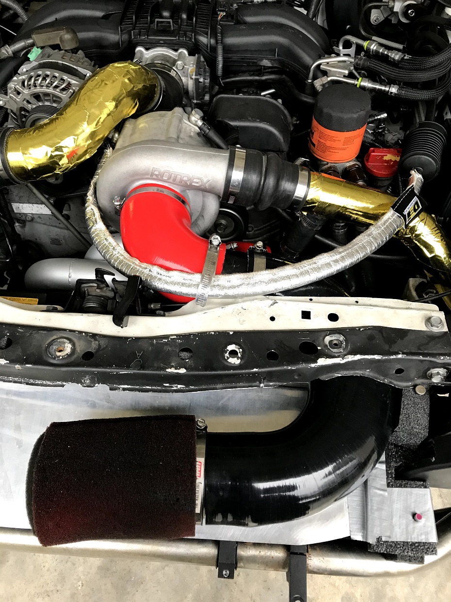

before anyone gets their torches out, this is just a test...of intake temps...because I want to verify what I read online. I have multiple hot things in my engine bay...
Attachment 185313
I also thought about insulating the intake pipe connecting to throttle body. But I thought it would not help much with the heater hose connected to throttle body anyway. Do you see improvement in power?
