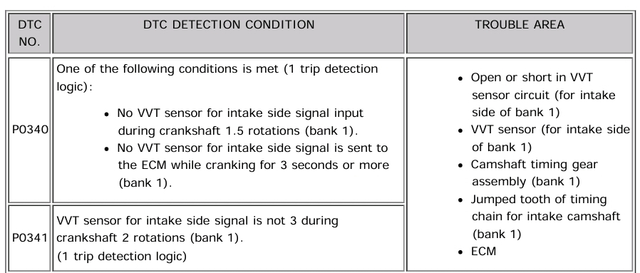

Swapped intake cam position sensors Pass to driver's. My P0341A did not change. Now, I've got to dig a little deeper. RSM is available to help but from afar. I found a diagnostic procedure for a 2013 Outback. I'll try to replicate it with mine.
Name:  Screenshot_20240729_083226_Adobe Acrobat.jpg
Possibly caused by the gap between the sensor and the cam trigger plate?
BRZ TSB 11-130-13 CAM POSITION SENSOR.pdf
Attachment 225561
Thanks. Good suggestion. RSM has made a bunch of these plates and I'm sure it's all cnc machining for consistency. I'll rule out a wiring issue first.
blsfrs is online now   Reply With Quote

Got my new belt. Fits like it was made for the car...Oh yea, it was. Lesson: you can't use the 2013-2016 belt on the FA24's
I tracked down the P0341 code to a loose wire in the plug to the sensor. RSM is sending me a new pigtail. None of the local part store had the right one.
