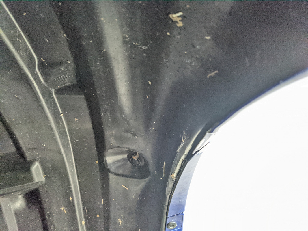

That's @trippinbillies40 and he's already on this thread:
Originally Posted by trippinbillies40 View Post
So, there's a little bump out in the fender liner just inside of the fender lip that is what the tire has been hitting. I'll try to take pics later today, but I think the "less rubbing" has been a self clearancing thing lol. +35's with 245's might actually work. I'm tempted to try it with another set of Enkeis and some 245/40/17 PS4S's for tooling around in the winter here and back up heavy rain autocross tires.

Edit : so it appears to fit exactly like 1st gen. +45 is too inward up front and you fiddle between 35 and 45 with 245-255 tires rear depending on how low...

@trippinbillies40, please help us understand which area of the fender liner that is.
Is it where the rear bumper meets the quarter, or where the rocker meets the quarter?
Have you tried to peel the fender liner and see what's behind it?

We can see the pin of the bumper like on the 1st gen.
Would be great to know the rear camber. Seems like nothing a few mm of height increase can't solve
