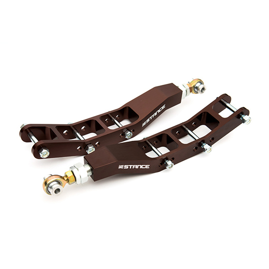

What's the point of remaking the exact same straight piece as the stock arms? A truly useful design would be to lower the mounting point where the rear strut mounts to the arm to allow more suspension stroke back when you lower the car. The rear strut setup already has a very tiny stroke, I don't see any benefits of this arm other than allowing for more adjustment with camber because of the adjustable ball joint.
Now these Stance LCA seems to have some engineering behind it.

If they're strong enough, they're a lot heavier than they need to be... Don't understand why TWO different aftermarket sources are making aluminum arms that are all blocky/bulky/solid in areas of low bending moment, and reduced to two thin blades with holes in them where bending moments are greatest.
NOT designed by structures guy, that's for sure!
