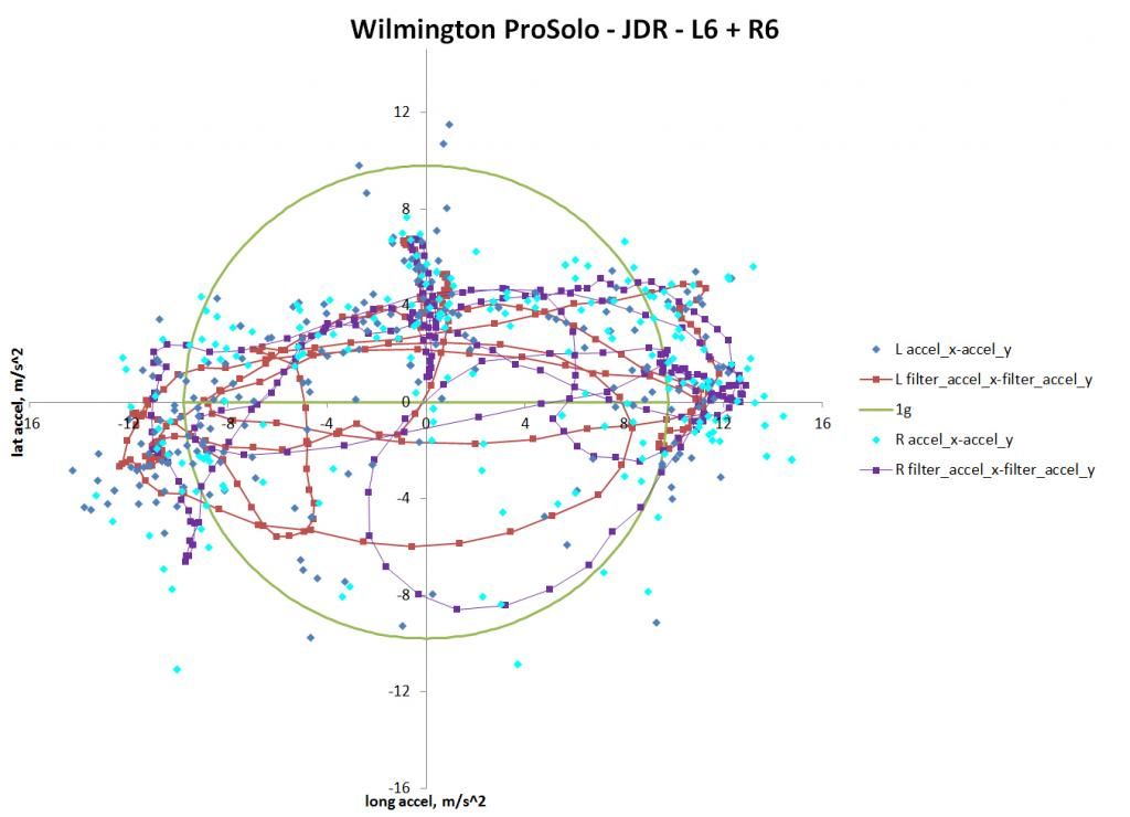

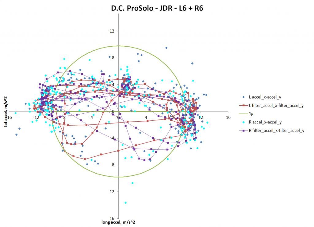

I'm curious for those that are taking data - Does your car generate more grip to the left than the right? My car consistently produces 0.05G more then turning left than right.

I tend to make more g's turning left as well
but I attribute this to a) better weight distribution for lefts and b) higher confidence knowing that I'm not gonna tap a cone

left turns. better weight distribution and RF generally has more camber than LF.

FWIW, this data is from the accel(s) in a Galaxy Tab 3 8.0 as collected by SoloStorm - my quickest L/R pairs from DC (not flat blacktop) and Wilmington (flat concrete). I don't see any significant L-R differences. (0.05G = 0.49 m/s^2)

Now write a quick script in excel to filter out anything that occurs for less than .25 seconds a time. It would be nice to see a more accurate number for 'sustained' g's.
I see you have a lot of 1.2..ish...data, I see about 1.15 on street tires sustained and 1.35 on race tires.

Well, the data with the line is already 'filtered' by SoloStorm, though I've not seen any detail on what that entails. The unconnected points are presumably the 'raw' data. Also, SoloStorm is a bit inconsistent with the data rate (occassionally 'skips') but most of the points shown are at 0.100 sec intervals. So, if you see 2 or 3 connected, that is >~0.25 sec of data.

Thats about what I expect then, same I see. I never used the export raw data feature in solostorm, I usually just slide through the data until I get to a big sweeper and look at the data their to see how my lateral grip is (assuming Im driving at the limit).
