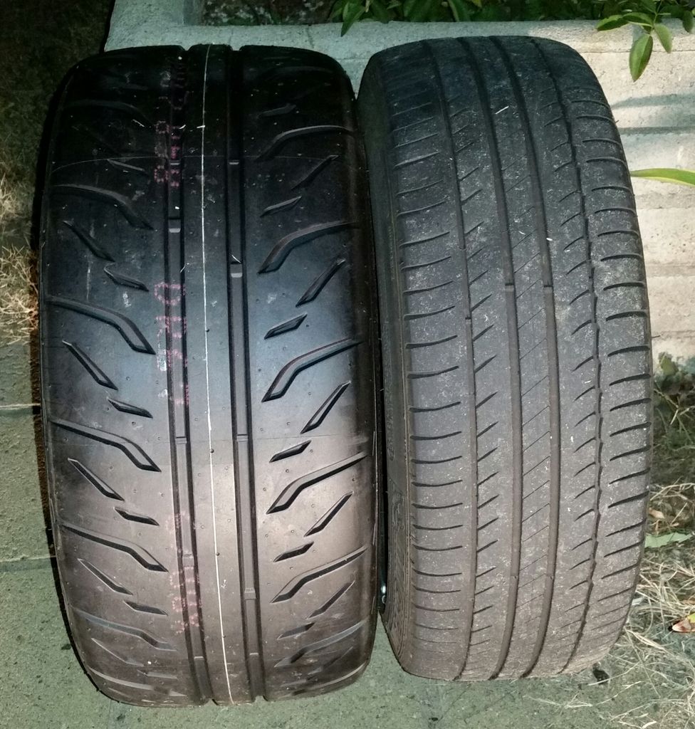

245/40R17 Bridgestone Potenza RE-71R on 17x9 +45 Enkei RPF1.

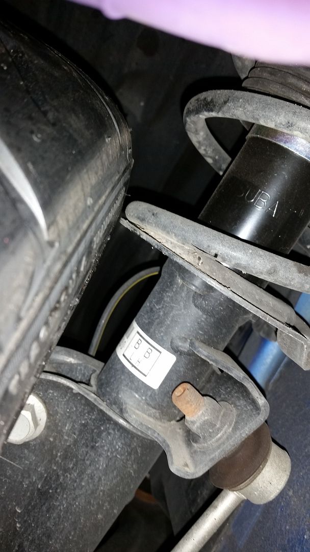

This setup left me about 1 mm. from the stock suspension. Definitely not acceptable for autocross... or anything really lol

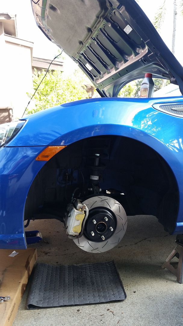

DBA 4000 T3 rotors, Winmax W3 pads, and Motul RBF 660 fluid. Once warmed up, they bite hard.

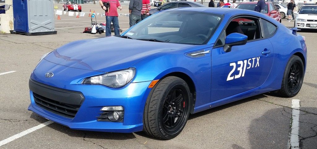

This is River. This was at the first SCCA San Diego Region Solo II autocross of the year on January 9th, 2016. She placed first in class, but almost none of the regular competitors showed up. So we'll she where she really stands at the next event
