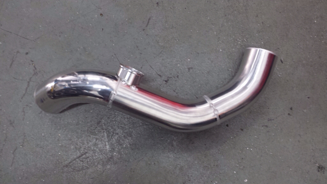

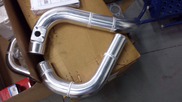

FA20Club old intake charge pipe
3", x2 45 degree bends, MAF flange on a bend which creates partial throttle cruising issues
FA20Cluv new intake charge pipe
2.75", 90 degree bend, MAF flange on a straighter section to create less turbulence. Not perfect but better.

Looks good! How much did that set you back? I am interested in seeing if it helps your issue.
Well it took awhile to get this made and @ptuning finally eliminated the cruising and partial throttle fuel trim issues. That intake pipe is slated to be delivered today, but I don't need it anymore. The issue with my desire to install it will be that it will require a retune. I'll probably install it sometime in the spring/summer.
The cost was $164
Attachment 69510
Attachment 69511
Sucks that smaller pipes tho
Your statement is incorrect.
A 3" charge pipe for this car was only done so one could run a MAF based tune only. That was way before EcuTek updated their racerom to include speed density.
Now with speed density, there is absolutely no need for a 3" charge pipe and the better tuning option would be one that is MAF based for light and partial throttle conditions and switches to speed density when you put your foot down.
