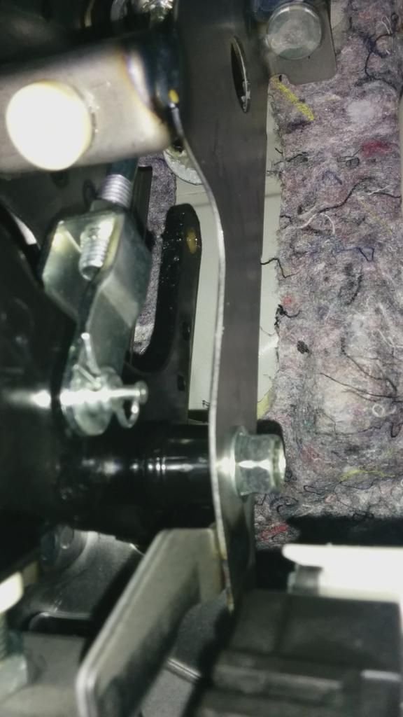

Can anyone provide better instructions for this please? I got the c clip out with ease but spent half an hour fighting that rod to come out and it still hasn't come out. I tried using needle nosed pliers but no luck.

Remove the pin that connects to the pedal to the fork that actuates the clutch engagement. Then push the pedal till it jerks to the floor (spring uncompresses). Push the rod out with your needlenose.

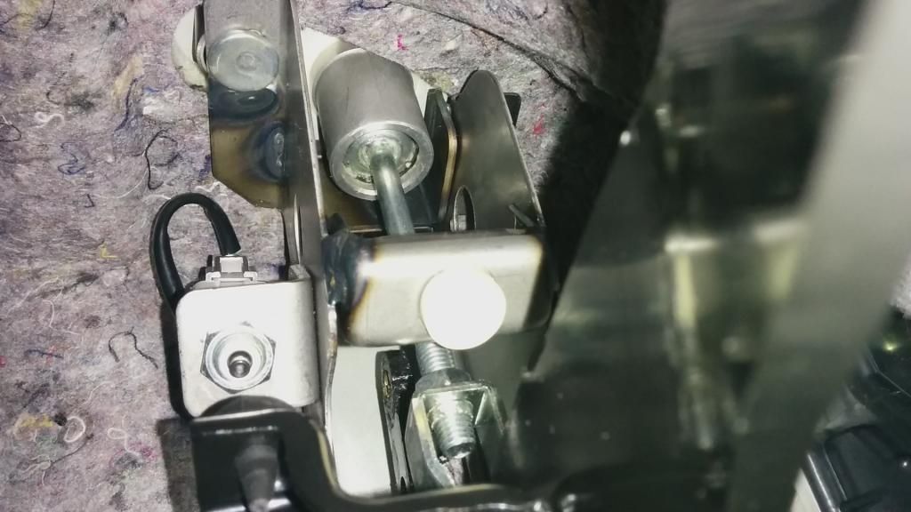

Thanks to the man that mentioned removing the pin and rod that connects to the master cylinder assembly, this freed up the clutch pedal and allowed me to remove the spring in two minutes. I have to say that the car feels amazing, no more guessing where the engagement is, you feel the pressure, engagement/disengagement points directly. There is a slight maybe 1/4"-1/2" free play but i think this is normal in any manual car, we never noticed because we had the dummy spring.
I think for the first time i've felt the rear tires lock when downshifting hard..i guess before subconsciously i never allowed the clutch to kick back to just that point due to the lack of feedback.
PS- BTW i put it back just for the challenge and its not that hard, you just need a nice long flathead to pry the spring back down as you insert the top onto the clutch pedal. Force needed.

so basing off the fact that no RHD owner posted about removing it (google search inc.) and that it took me 4 hours worth of failed attempts and 6 hours (with frustration breaks) to actually remove the thing, I may be the first RHD 86 with no clutch spring!
Its next to impossible to even touch the spring, those two plates restrict access completely. I found that disconnecting the clutch rod from the pedal made life much easier allowing the pedal to stay full engage or full disengage only.
remove that clip and pull the rod and the pedal will be disconnected from the clutch. keep the pedal to the ground now to relieve spring compression,
the only way you can remove the spring clip is using two screw drivers and turning the clip to the open section and pushing on both ends. you cant get a screw driver to the side and pull from the inside of it, there's just no room. once the clip is off the rod is all that's left and I found that the last few mm of the rod was actually quite hard to remove, it'll eventually come out though. Then all that's left is to push up on the spring while pulling back the clutch pedal to separate the two and its off.

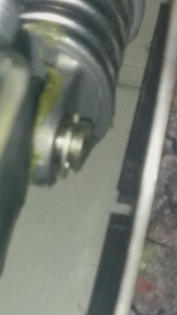

I used needle nose pliers. I'm not sure why but I managed to pop out the little clip. Now its somewhere but I can't find it. I used the same pliers to push the pin a bit then a flathead to push further. I ended up pushing the clutch pedal down and leveraging another piece of metal to pop out the pin. I can't find it either. I think it went into that place where the hood switch is. I pushed the clutch in again and leveraged using a wide tool to pop the spring out. This took half an hour because I was dumb. Should only take 10-15mins. Finding the parts will take longer.
