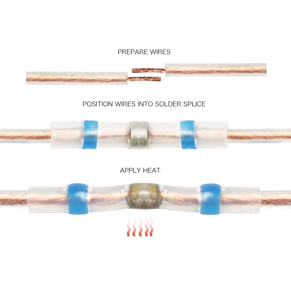

Just cut and resolder the cables needed. You can use solder connectors. Ford uses them for all their card

Cut and resolder is something I would've done but it ends up looking ugly. Only do it if really needed.
