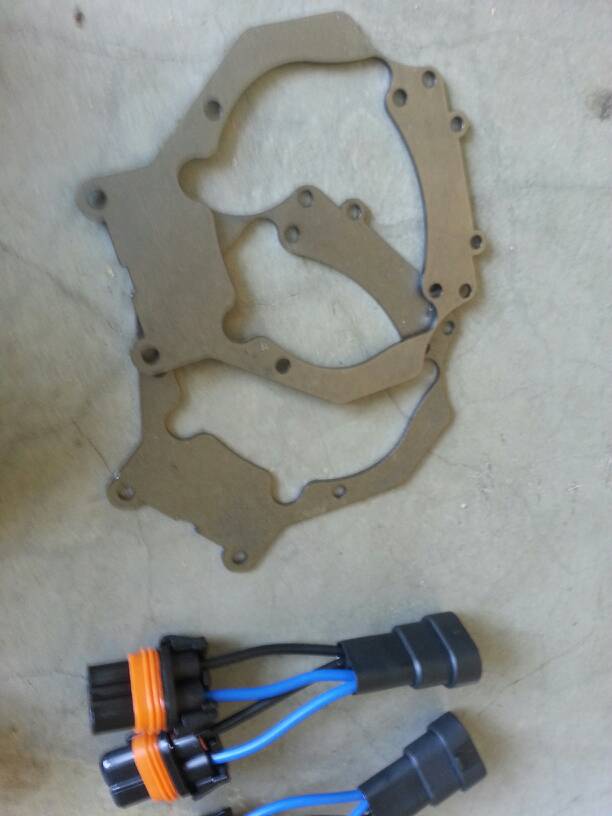

Does this look like the correct kit? Just want to make sure prio to pulling the headlights.

take better pics of the projector, we can't tell if it's the correct kit if the projector is still in the bubble wrap.

Looks like you've got everything.
