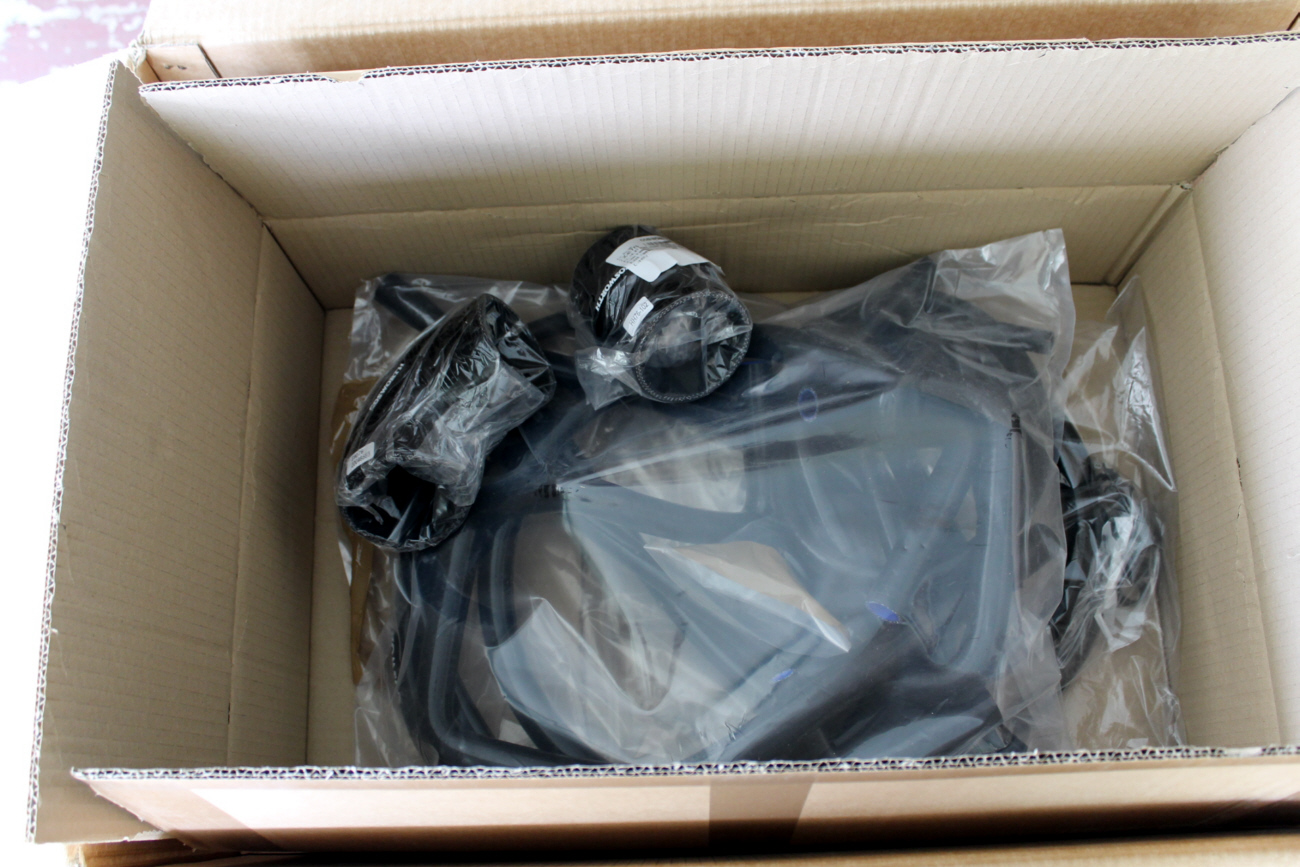

Hi guys,
Some prep before the installation was done yesterday
All neatly packed (I'm suprised once more how much you can pack in this trunk)
