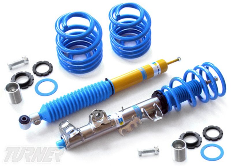

stock suspension is silent
some coilovers are silent
some coilovers are loud AF
Clipdat is on aftermarket coilovers. For spring binding you need to ensure you have good pivots and bearings, the get dirty and gum up, even a little plastic disc can alleviate a bunch of noise.
Bilstein ships with a lame little plastic disc shown in blue in the bottom right as a ghetto bearing to reduce spring binding.
OE spring perch up front rotates extremely easily and provides little resistance, some camber plates aren't as free spinning, but iirc Clipdat has Racesengs which should be good as long as they're clean and lubricated. I'd be surprised if that was the problem but the springs could be binding on lower perches or with the helper/tender spring.
