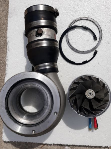

Took the blower off and it's blown. Looks like the bearing gave out finally after millions of cycles. I'm really surprised it lasted this long.
If anybody has a Phantom blower they want to get rid of, I want it. Otherwise I'll have to try to cluge something up. I think the blower is the output side of a booshiwheel modify turbo 49179-520 0. Chinese of course. $100 to $1000 on Alibaba.
If anyone has any great ideas on what to do please let me know. The cars got over 200,000 miles so it might be too old for a real supercharger.

Took the compressor apart and the motor is hard seized. Can't turn it at all. I thought the worst thing that could happen would be the controller frying.
I was wrong. The worst thing would be the motor seizing. The controller might be fixable. The motor is not.
So, I need to buy a motor with compressor wheel or I need to sell an ESC kit minus the compressor.

My compressor "shell" is OK. Whenever the motor failed the compressor wheel contacted the shell and scratched it up a bit but it can be polished out. The wheel needs to be replaced which is available. The motor however is completely seized. I've read through the open source build thread but it doesn't end well. Still trying to find a replacement motor but my hopes are starting to fade. It looks like the motor was custom made. I don't know how that was done on such a small production run. But that's how it looks.

Autopsy is complete. Looks like what happened is the bearings failed. The motor has a (had a) bearing at the back of the shaft and one at the front. Looks like they used to have tiny ball bearings. I removed the rotor from the stator then replaced it and it is no longer seized. I could probably just replace the bearings and the motor would be fine. (If I could find the bearings). The compressor wheel was slightly damaged and needs to be replaced. I know it needs to be perfectly balanced. The compressor housing is scratched but can be reused.

I got the motor to work. Yay. But the rear bearing isn't quite right and I'm having trouble finding the right one. Turns out the motor shaft is 8mm in the front and 6mm in the rear. I got a good 50,000 rpm bearing for the front but the rear I'm still looking. The highest speed I've found is 38,000 rpm. To test the motor I used a 8mm bearing riding on the remnants of the old bearing. Just for a proof of concept. I'm looking for a ball bearing with 6mm shaft and 19mm housing dia good for 50,000 rpm.
Once I get the motor fixed then I have to move on to the compressor wheel. In my research I discovered that apparently this is a very large turbo compressor. The wheel has a 98mm exductor and a 65mm inductor. Haven't found anything even close yet. If I can't replace the wheel, then maybe I can send it out to be rebalanced. Or maybe it doesn't need rebalancing. Some of the metal was "displaced" but not removed. We'll see. But at least now my hopes are up to get this thing running again. The car is scary slow without it.

I got the right bearings installed and the motor runs like new! I ran it with the wheel attached and it seems to run fine. Next step is reinstall it in the housing, attach it to the intake and see what boost I get. I'll do that next time I'm feeling lucky. Wish me luck.
For anyone who's bearings are worn out, these are what I used:
Front bearing: 57155K496, 8x14x3.5mm flanged with 15.6x0.8 flange good for 50,000 rpm from McMaster-Carr.
Rear bearing: SMR626C-YZZ NB2, 6x19x6 ceramic bearing good for 60,000 rpm from Boca Bearings.
