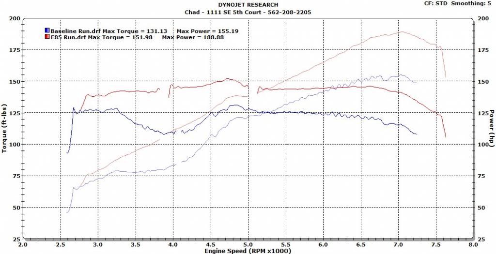

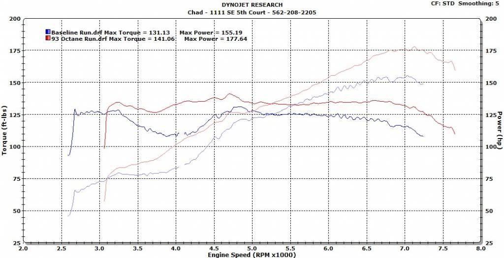

So today I did some E85 tuning with @FA20Club.com and I wanted to share the results. I have really enjoyed the 93 octane tune with the Borla UEL as the TQ is far improved and for actual driving (not redlining each shift) it is awesome. We have played around with the E85 for a while now but today my goals for Tony were to get as much midrange power as possible and not concentrate so much on the "peak" numbers. We were literally in swamp conditions with temps in the 85-90 range and a torrential downpour starting 30 minutes prior to the pulls and lasting throughout the day. I am still extremely pleased for less than ideal conditions.
Tony has also supplied me a baseline run from another BRZ on the same dyno. He runs tons of FRS and BRZs on this dyno and the stock numbers are always consistently in the same range. He gave me the most average of average baselines just so you can see the gains across the board with the mods I have currently installed.

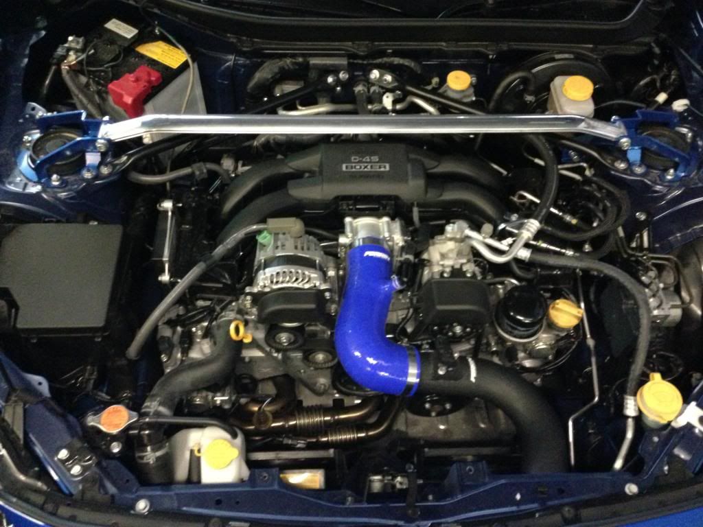

I am running a Perrin CAI and silicone intake tube, Perrin pulley, Borla UEL, Perrin Overpipe, Perrin Front Pipe with HFC, and Perrin Resonated Catback. I am running ecutek/FA20Club tune with 4 maps..2 93 Octane and 2 E85. This is a full bolt on build at this point and pretty easily attainable by the masses. No oil cooler or engine mounts yet but those are next before FI.
Here are the results...Baseline and 93 Octane from last tune session first.
And here are the E85 results. You will see two spots where the tach pick-up lost signal momentarily but they are not dips in the power delivery..just a brief second of no signal during the run. If you notice there is NO TQ DIP at all. NONE!! This car pulls hard no matter where you shift. It is a handful in wet weather as it spins 1st through 4th gears with minimal throttle input. In the dry it is epic! If it just wasn't so damn hot and humid down here all the time I wouldn't be shopping turbos...

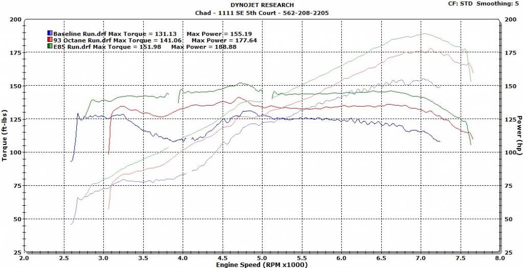

And lastly, here are all 3 runs on the same chart. With the loss of signal in a few areas it's hard to read with all 3 runs... but I figured I'd post it before someone asks. I am pretty good with photoshop and I could easily clean them up but I don't want anyone of accusing me of messing with the actual results.

Lookin good Bro' whole lot more fun with the torque dip gone eh? dang rain looked like you were dynoing in the amazon...
We were in the worst conditions other than adding in some really high altitude. It's HARD to make big power NA in this heat and humidity but the cars do run great on the few cool days we get each winter. I think if I still lived in Orange County, CA I wouldn't be on such a hunt for power.
The car is a blast to drive now without the TQ dip!! So much better!!

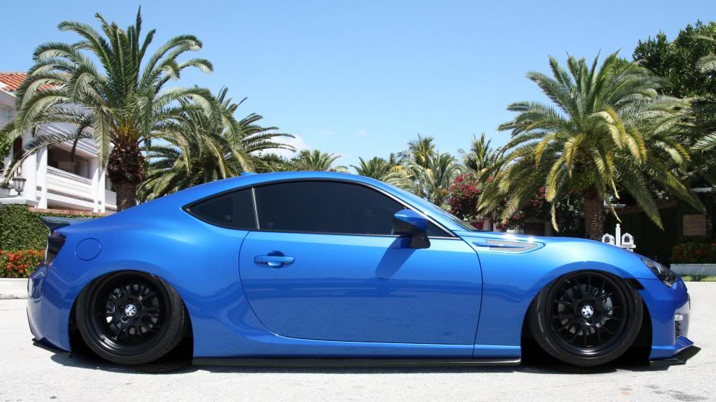

I could never ruin my car by bagging it but wanted to see what it would look like. I know some people love this look so I'm sharing..
