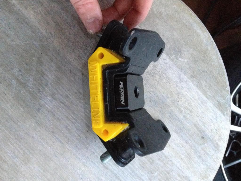

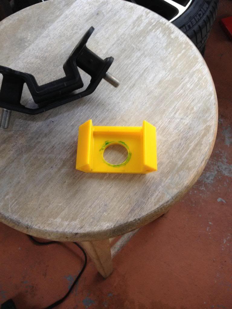

Wasn't that bad at all, just make sure you have 1 or 2 swivel sockets and your good to go. Only thing that took a little while was using my dremel to expand the hole in the whiteline insert so that I could use it with the Perrin Insert too.

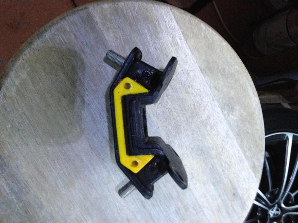

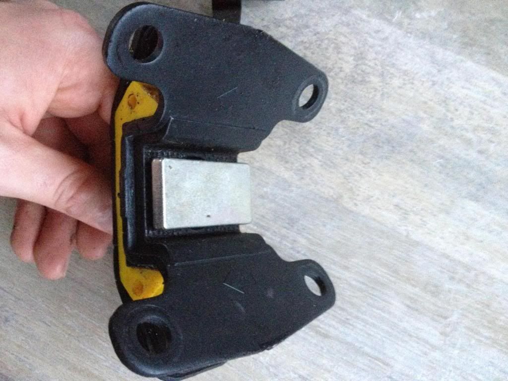

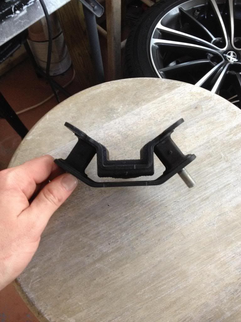

IMHO I believe the Whiteline Bushing insert would be the better of the two because it fills in the massive void in the stock transmission mount. If you decide to go with the white line then make sure you do the rear shifter bushing too while your under there, its just a lot easier to kill 2 birds with one stone
Btw heres the stock trans mount.
Then with the white line insert.
White Line insert w/stock transmission mount support
Finished Product, Whiteline insert w/Perrin trans support.
Hope that helps
-Taylor
