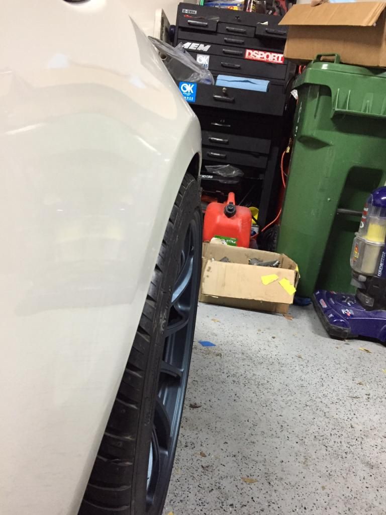

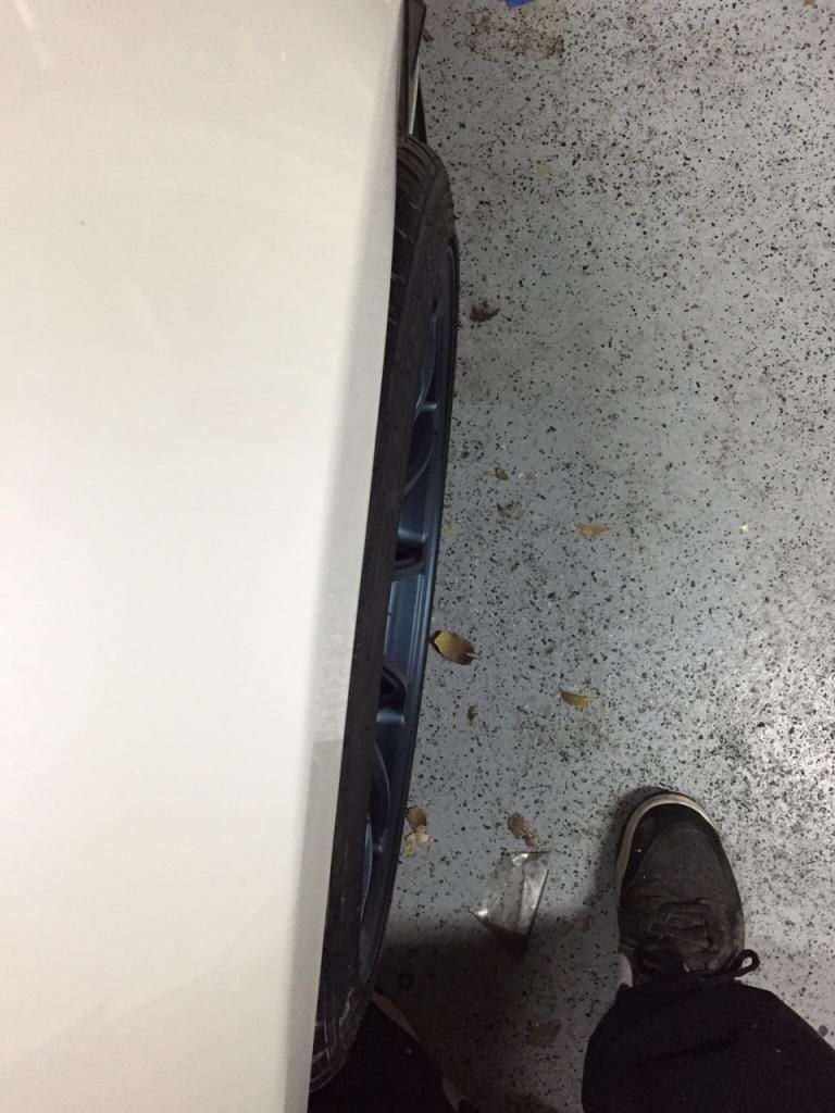

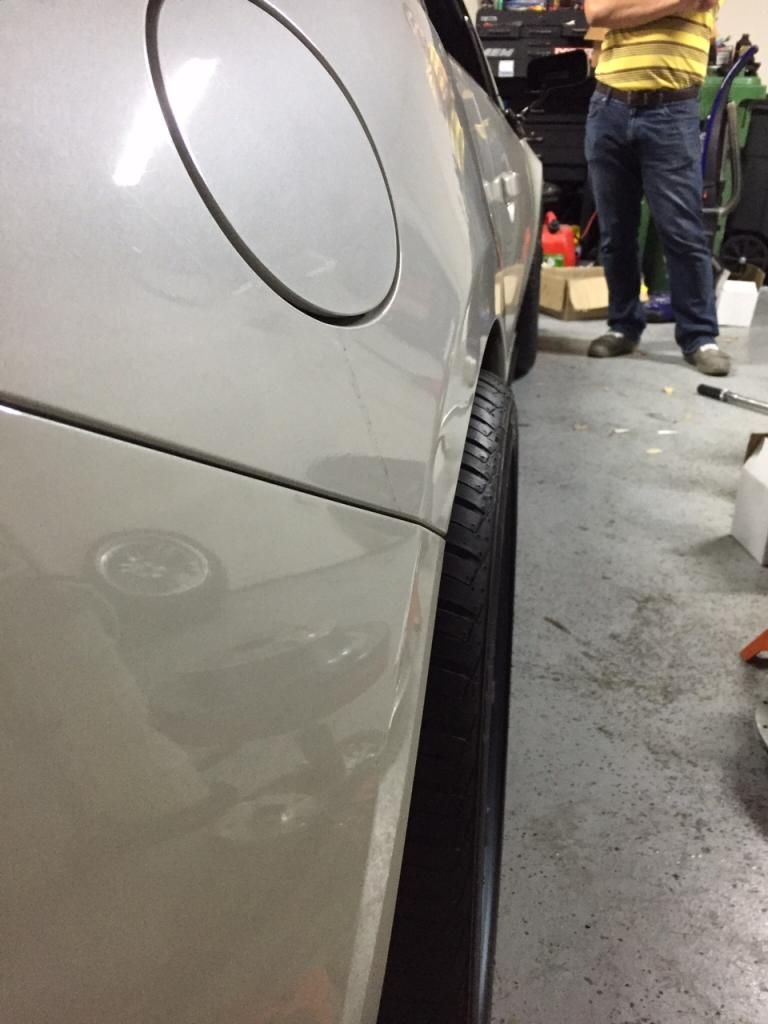

I have 18x10 +40 ZE40s and running 285/30/18 tires -2 camber up front and -2.5 camber in the rear.. Running KWV3 coilovers, whiteline adjustable toe arms, camber bolts and LCAs, HVT Camber Plates
I just lowered the car back down last night after installing the stoptechs.. So the springs haven't settled in yet, but the rears poke out like crazy..
As far as tire to spring clearance it seems to be ok, until I put some load on it.. Wanted to ask before I hit the road and cause some damage to my wheels and/or springs...
Anyone have any rubbing issues? @Jive Turkey @OmarGC @AutoRnD

Man that is a lot of rear poke, mine are no where near that and I'm currently -1.7ish out back.
As far as rubbing I personally have no issues, but am also only on 265/35's both front and rear. I cant recall the username at the moment but there is someone rubbing under full lock up front on the inner brake line bracket/mount...

Rear camber doesn't look like -2.5 if front was -2.
Front should always poke more on a square setup as the back has extra ~10-15mm.

I just checked, I don't have any issues rubbing on the brake line braket/mount
I think you're right.. I'll probably need to get an alignment again.. I did corner balance the car and the rear raised up a lot when I did it.. Thanks for the reminder!
