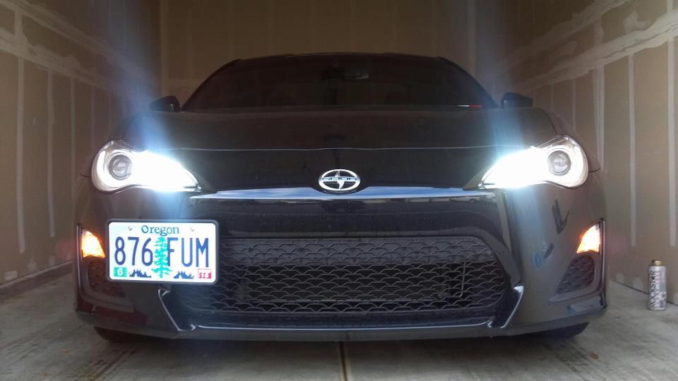

I agree with hating the pee-yellow stock FRS DRL. So instead of disabling the DRL altogether, I got 68 LED white LED for replacement.
They cost me about 30 dollars. It runs the LED at full power at all times. High beams are basically useless IMO however. But at least they look cool, which, lets face it, 99% of mods are for "looking cool".
EDIT: Ok, maybe not 99% LOL. The high beams also are rendered useless, I believe, because all 68 LEDS are not a concentrated beam of light. This causes it to scatter in odd directions. http://www.ebay.com/itm/White-68-SMD...cfe284&vxp=mtr

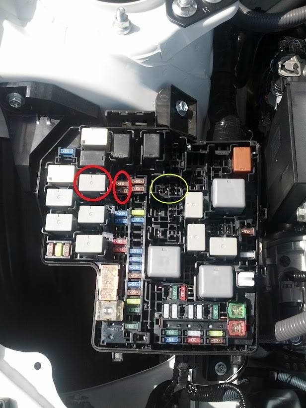

Can someone post a pic of where the relay is/looks like that the Napa AR6034 replaces? Pics work better for me.
Thanks,
Jacob
Disregard the red circled. I borrowed this picture from another thread. Working from memory but I'm pretty certian its located in the spot circled in yellow. Anyway it is clearly located by using the schematic underneath the lid to this fues box. Looking for DRL Relay
