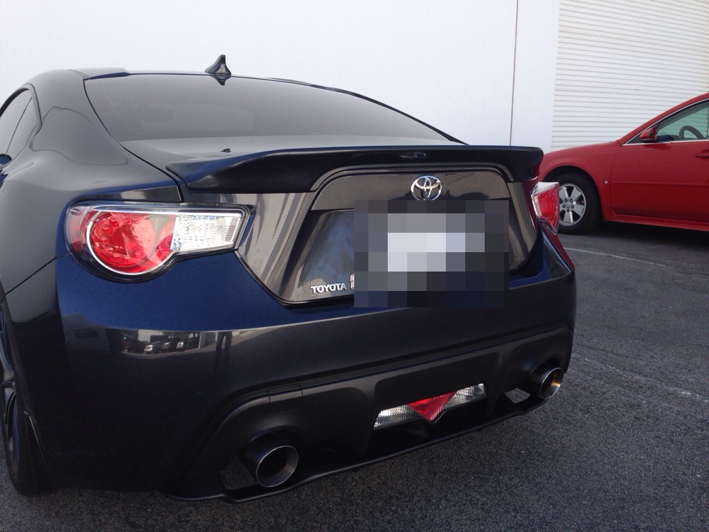

I just got the T-style spoiler & painted it myself. Couldn't be happier. Fit is perfect.

Thanks! It looks like its an ultramarine, but judging from your name its an asphalt, do you happen to have any more pictures of the spoiler?

Update: more pics posted. The asphalt does kinda have a blue metallic to it at certain angles.

Looks great!
Was the spoiler this one:
Link
Also want to tell us which paint brand you used?

That is the exact spoiler. I got the paint from AutomotiveTouchup.com . I used the spray cans. 1 can adhesion promoter, 1 can primer, 2 cans base color & 1 can 2K urethane clear coat. They have directions on how to make it look the best and stick to plastic on the website too.
