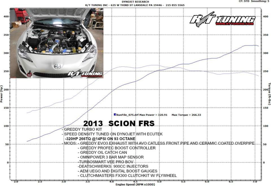

https://www.ft86club.com/forums/showthread.php?t=53124

More power mods have a feed forward effect on the turbo, so maybe if someone didn't have anything else going on for power or E85, and they could keep IAT down, but even then, we have examples of people doing 14 psi on pump gas.
That post if from 2013, all those engines have blown up!
