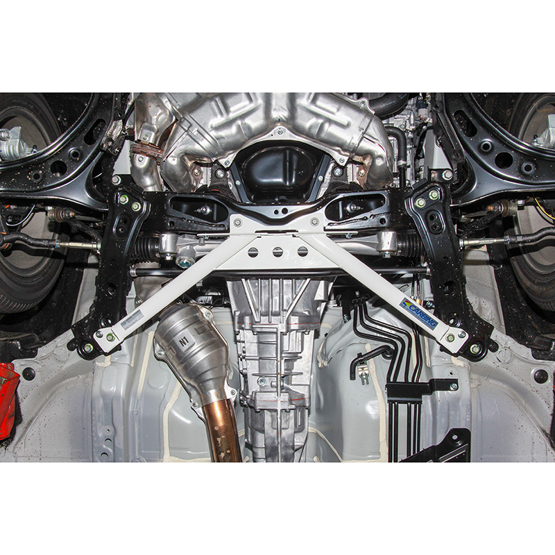

The Carbing brace seems like the one to get IMO in terms of design, just expensive...twice as much as the Cusco one.

I’m glad to see they are comfortable using the standard m8 bolts for that front mounting point. If I ever do the swap to the gr86 braces, I’ll probably leave those bolts m8 while the other 2 bolts will be factory m10.
