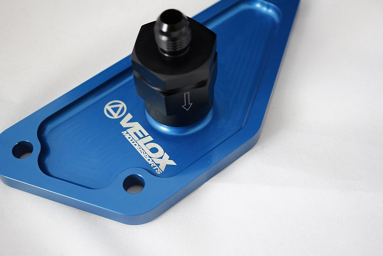

Is there a check valve in the optional drain back line to prevent positive crank case pressure from blowing into the can?
https://www.velox-motorsports.com/pr...-aos-drain-kit
Yessir.
