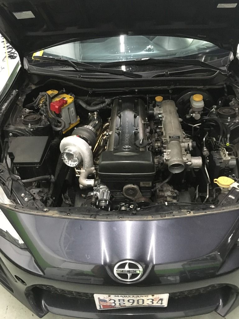

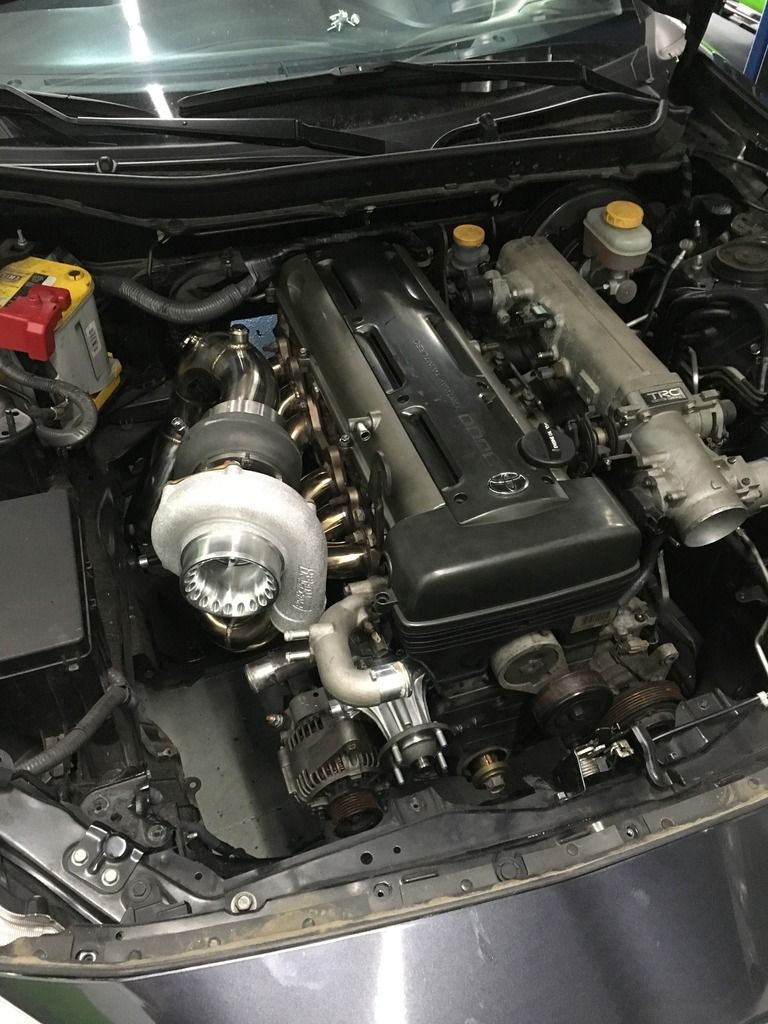

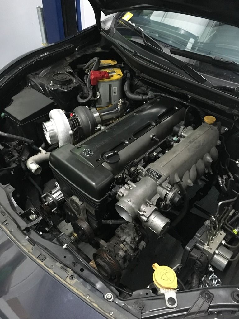

We have not abandoned this at all, just waiting on a lot of parts to get here!
We have a Precision 6262 Ball Bearing selected for the snail, we have T4 manifold on the way, we are working toward a repeatable engine harness solution, we are working!

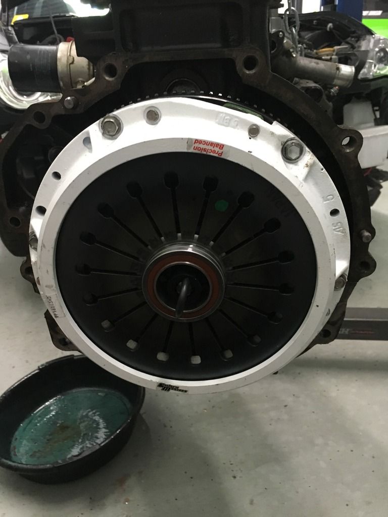

Clutchmasters FX400 Installed
Starting to look real!
Needless to say, we made a lot of progress this week. We are still ironing out positioning and height of the drivetrain. We are also still waiting on some oddball clutch parts to adapt the R154 trans.
We selected a Precision 6262 Ball Bearing Turbo because the customer wants quick spool up, but also wants 500-600 horsepower on pump gas. This was the compromise we ended up with.
Still no update on our big suprise, I'll just keep on teasing it for a while. Stay tuned for more updates as they are available.
