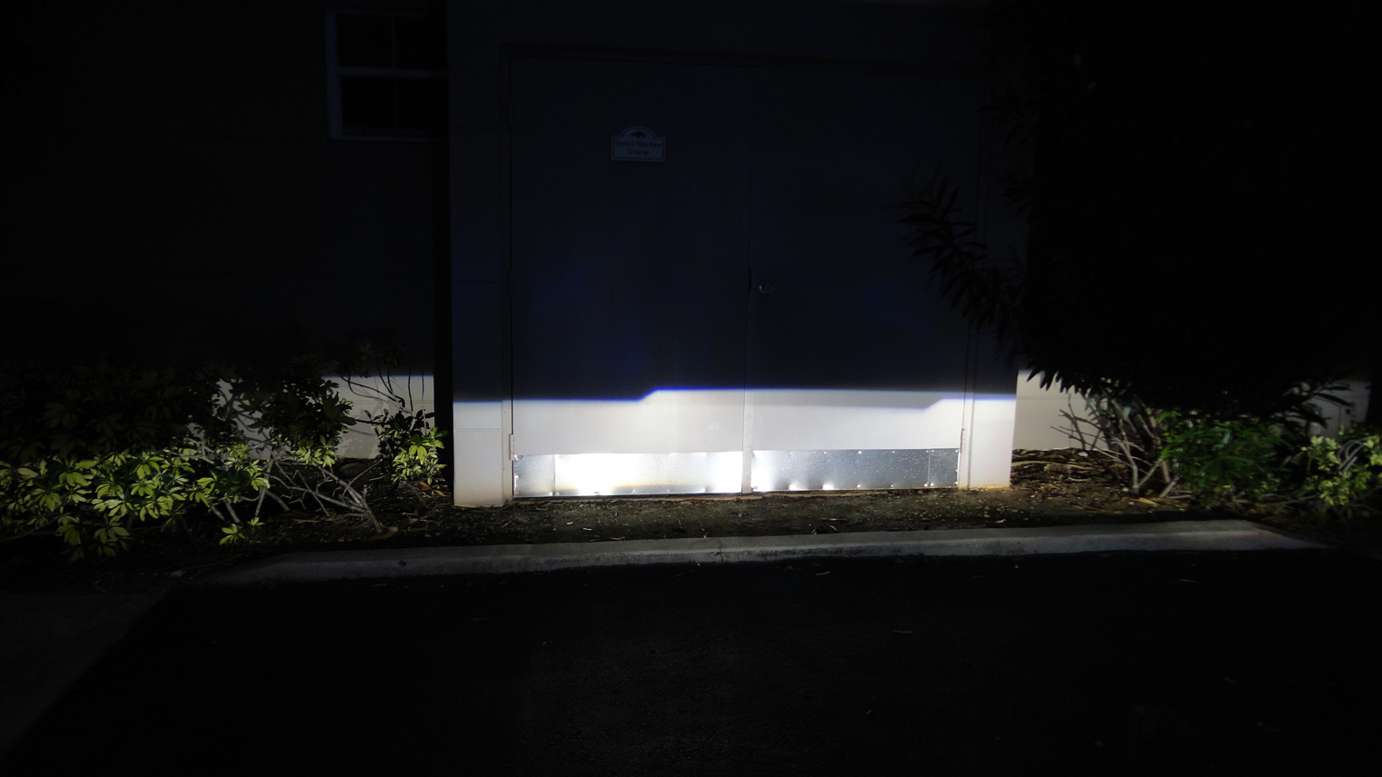

@raul - Looks like the passenger side beam can come up just a bit to be in line with the driver side.

Got em aligned.
