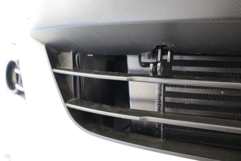

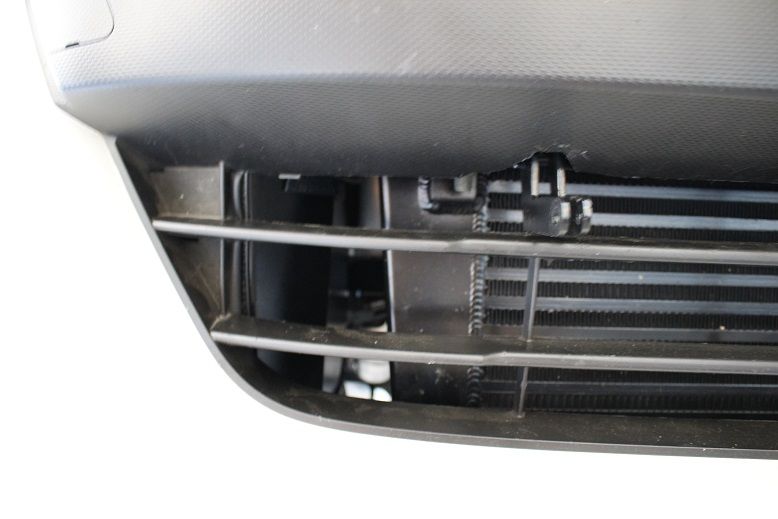

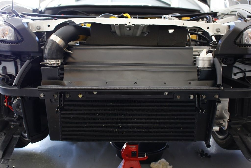

I got the radiator ducts cut out and bent up. I'm somewhat satisfied with the appearance (not the greatest fabricator) but I'm thrilled with how they will function. Pictures below of them, let me know if you guys have any questions.
Driver's side
Passenger's side
Center, poorly bent , duct
Driver's side with bumper installed
Passenger side
With these installed air will be forced through the cooling stack at speed. Very excited to compare logs from highway speed tests.

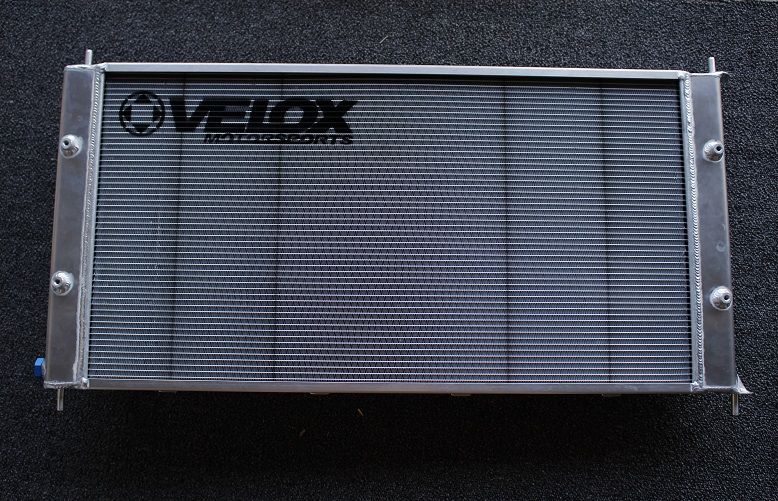

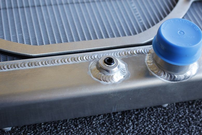

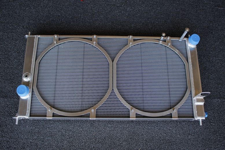

I also had to weld on a bung to the other prototype radiator I had made. He wants to run a temp bung on the outlet of the radiator so I drilled and welded an 1/8" NPT on. Pressure tested to 30 PSI.

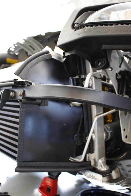

Originally Posted by civicdrivr View Post
I want to build a shroud for mine to work with the Vortech intercooler and JDL bumper bar. Might have to steal your mounting method
I was thinking the same thing... kind of inspired me...
I have to take my bumper off soon to modify an HKS air intake duct so I'll take some measurements for the shrouds then. I work with and have acces to aircraft sheet metal tools and materials so I'll be taking advantage of that.
This is what I have done so far..
Upper foam packing...
Lower foam packing...
Side(s) foam packing...

Originally Posted by johan View Post
Those shrouds are awesome. I've wanted to do something like that on past cars I've owned. What is that rubber piping you're using to seal them off? Is it self adhesive or did you use some kind of contact cement?
I refer to them as sheet metal seals. They actually slip on the edge of the sheet metal and have the large nice sealing surface already on them. Very neat for finishing sheet metal work and sealing at the same time, especially when you're not good at fabricating!
Please do! I hope it spurs more people to try their own. You could technically cut these out with sheet metal shears from scratch then bend on an edge of a table.
I wish I could do something for everyone that was nice but there are far too many variables to make an effective kit for everyone. It'd have to be turbo kit and crash beam specific.
Your foam looks pretty awesome! Love it! What kind of foam is that and how did you attach it to the parts?

With ambient temps in the mid teens today (115), I was able to test out the ducting and see the effect it may have on coolant temps. Below are my findings based off of EcuTek logs. AC was on full blast the whole time, just like previously.
At idle, coolant temps are now 4-5 degree C higher. This is to be expected as the fans are now pulling air through a thicker cooling stack (CAC included). Before it could get air from around the CAC, which 1) reduces pressure drop for the fans to pull through and thus increases airflow and heat rejection, and 2) decreases the temperature the radiator sees which also helps cooling. Let me know if this doesn't make sense to anyone.
At freeway speeds, coolant temps are 3-4 degrees cooler. Air is being forced through the radiator where before it was spilling out/around/over. The ducts should improve cooling further at race/track day speeds.

Keep in mind I'm bumping up against t-stat temp. At freeway speeds before I was cruising at between 93-96 C depending on traffic. I'm now somewhere between 90-92 C. T-stat is likely slowing flow so these "tests" aren't the best at showing what is really happening; however, it is what I am capable of doing right now.
Originally Posted by gramicci101 View Post
Eric, I thought I saw pics of a fan shroud in the works. What kind of fans are you using to test your radiator ducts? If they're OEM, would a proper fan shroud and better fans make a difference in temps?
No shroud for me. SPAL fans on fan rings. The OEM unit is the best fan shroud I've seen to date. Everything available on market is bent sheet metal with stronger fans, which is not better, just more airflow from higher output fans.
Fan shrouds/fans will only be useful at lower road speeds (sub 30MPH), and if they are helpful at higher speeds than that, something is not setup correctly in the system. Think about it for a second; fan shrouds actually block airflow at high speeds; increasing drag and reducing performance.
Originally Posted by DHitHim View Post
Nice! I want to make my own too. How did you cut the metal?
Vertical band saw. You can also use sheet metal shears. There is no reason someone can't get a bit creative on their own and make something similar for very minimal costs in tools.
