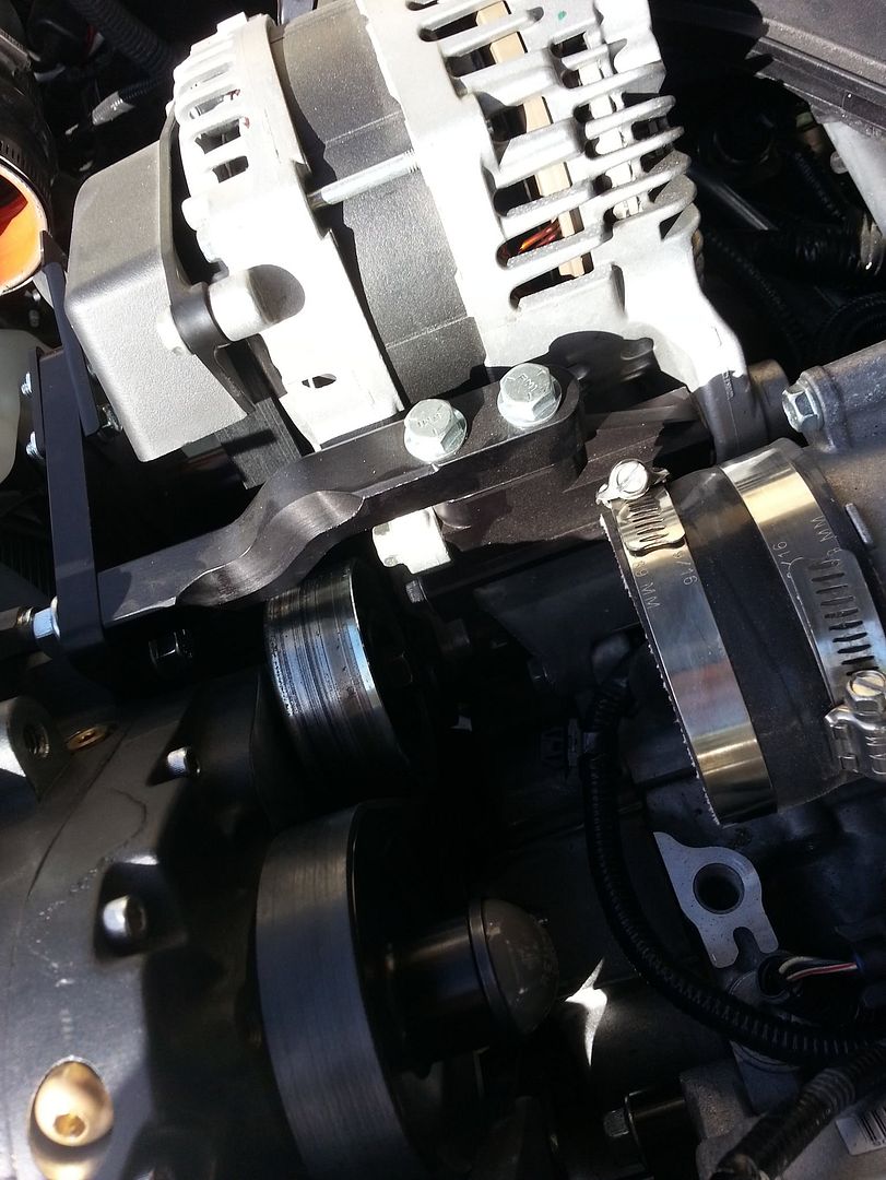

Originally Posted by DJCarbine View Post
My suspicions were correct, the pulley you remove during the vortech kit install FITS in the spot of the plastic pulley that seems to have failure issues.
You simply turn the pulley around and use the spacer that came off the plastic pulley.
A nice steel housing, OEM pulley. I am still going to swap to the ACDelco/Gates pulley when I get them, this is just temporary "get the car running" rigging but I think it would work long term as well.. the pulley is slightly larger (3-4mm diameter) but there seem to be no issues. Just started it up and everything is good. Belt tension seems about the same even though the pulley is slightly bigger.
Very useful if your pulley dies and you still have your OEM one.
What is the part number for the ACDelco/Gates pulley replacement your going with?
Gates/ACDelco 38006
