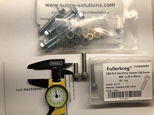

STI strut tower bar (with spacer) installed with Harrop SC pics

I don't remember seeing any pics of this product installed with a Harrop SC , and most of the info that is posted seems to be scattered amongst the dozen?hundred?gazillion? posts on the subject.
One important bit of info that is absent from the majority of the post is that a spacer is required to obtain the clearance between the top of the SC and this strut bar. Thank you to whomever previously mentioned this fact(?-is there another way). I experimented a little, and eventually decided it was easier to buy spacers already on the market, and modify to fit. All the ones I found were marketed toward rallycross to raise the vehicle. Plenty of companies making/selling different versions. I originally intended to use this ABS version as a template for modifying a similar aluminum spacer, but so far it seems to be holding up.

This version of spacers came with mounting hardware which seems to fit with OEM shock mounts. If you have Raceseng CasCam plates, then you gotta get longer bolts. I bought 35mm long replacements which give plenty of thread protrusion (can't have the nutplates falling off/lost as I make adjustments 5 minutes before hot laps begin...thats how I roll).
