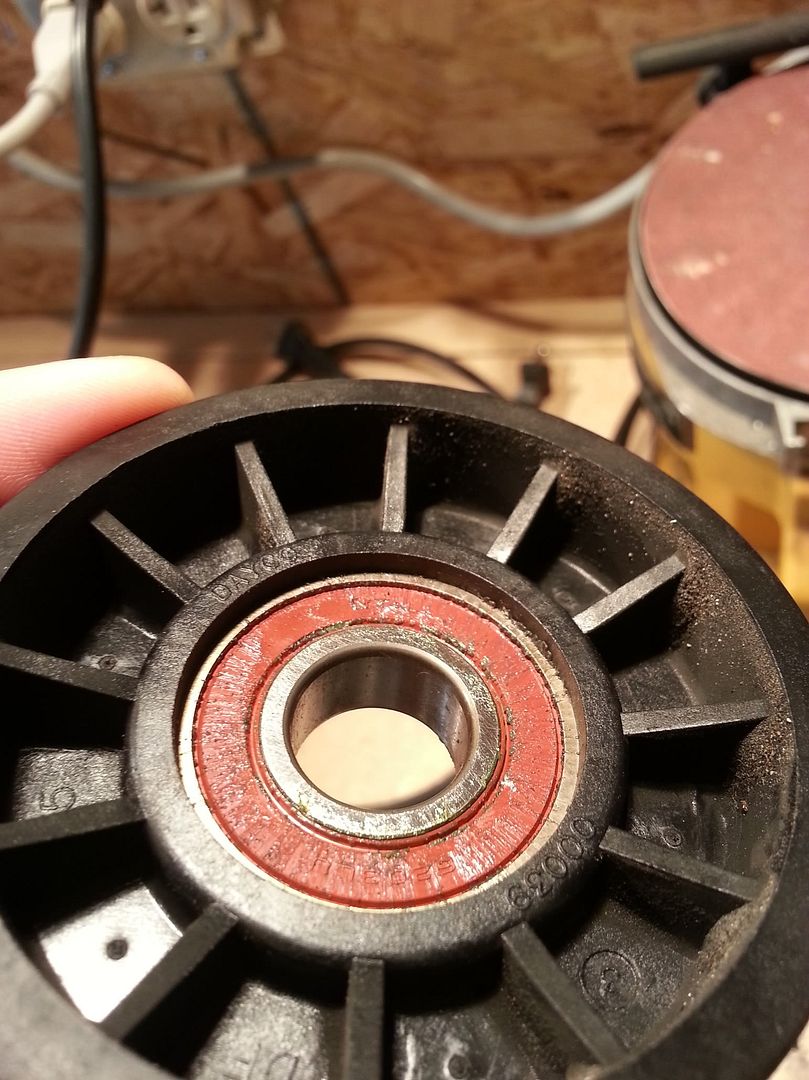

Close to 9K on it, only noticed squeaking the past week... however it was LOUD today.
Not too happy with the results of my findings, as I am currently recovering from surgery and I probably have no business working on cars........
Bearing is SHOT. Rubber belt deposits on underside of charge pipe.
Grease is leaking out of the bearing, most likely due to the decent amount of radial play (wobble) which I'm sure does not help the bearing seals function properly.
Bearing is an NTN 6302LU, and apparently the grease inside is green because most of it has been vomited out onto the surrounding pulley

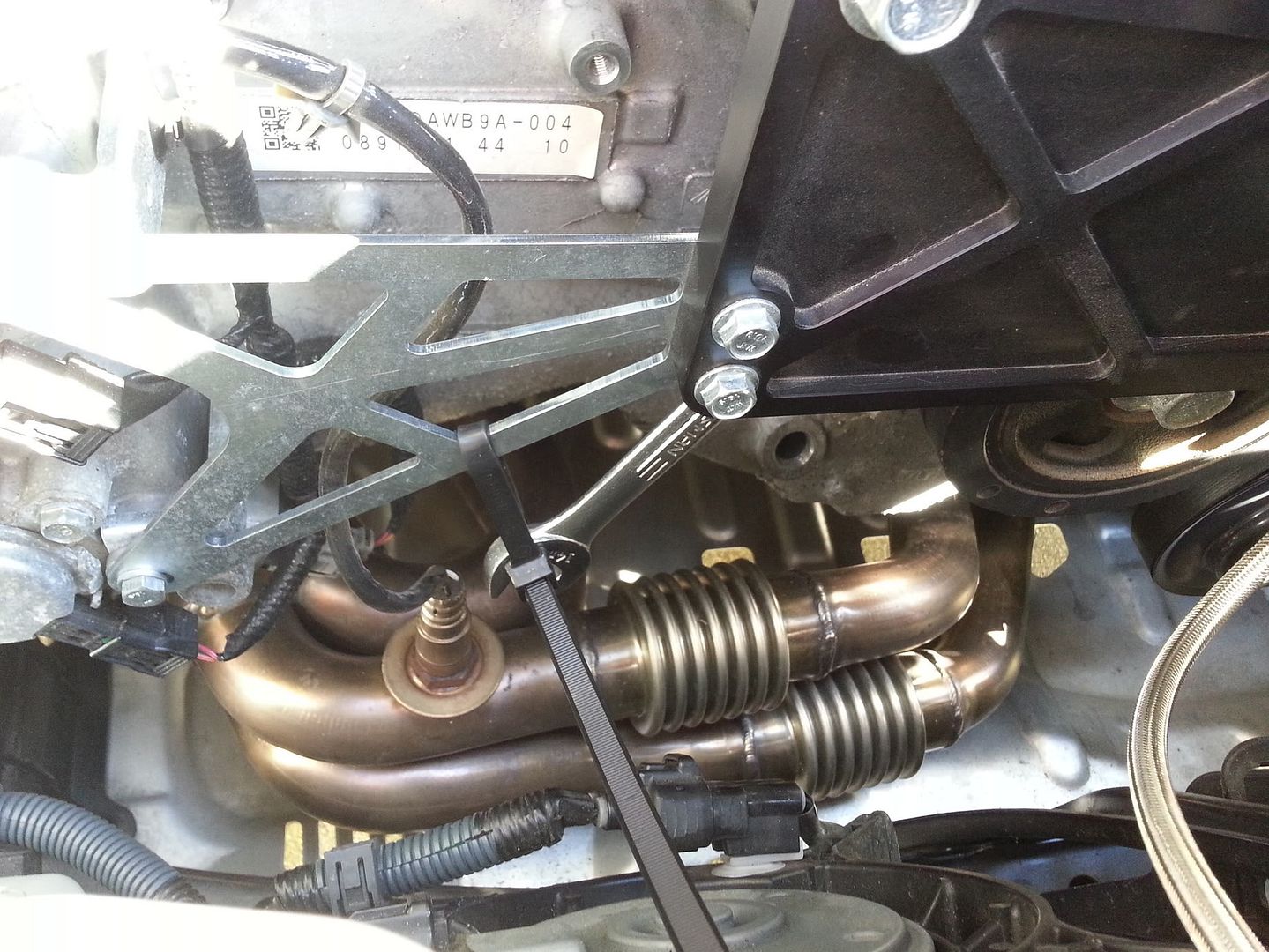

I do have some pointers for those changing their pulley (as I would recommend simply due to the track record of the stock plastic dayco pulley)
1. Remove the upper charge pipe that connects to the throttle body and covers the pulley in question
2. Remove dipstick
3. Put 14mm wrench on tensioner pulley and rotate clockwise, then ZIPTIE the wrench to the support bracket as shown in picture. This holds the tensioner open so you can remove/replace the pulley without worrying about the belt.
4. Remove the pulley bolt/pulley assembly
With the 14mm wrench ziptied the belt has no tension on the pulley and you can remove/install the pulley as fast as you can undo the bolt holding it on.
Picture of the bearing with grease leaking out.....
You really need to hold the bearing to see that it has failed, grabbing it while it was mounted resulted in a good amount of wobble/play... I'm sure it would have failed once the grease ran completely dry, snapping/destroying the drive belt.

Thanks for posting up, guess the question for Vortech is why is this happening? Shit pullies/bearings? Whats the long term solution?
Could this be heat related issue? This pulley is behind an oven of a blower, underneath 120F intake pipe and facing 200F motor.

I'm thinking a batch of bad bearings personally.....

Not a bad idea to hold the tensioner but I'd try something stronger than a zip tie. If that zip tie gives out, your fingers are toast
The ziptie is VERY thick, they are rated at 250 pounds tensile strength IIRC.
The tensioner doesn't require much torque to move it, its just an ever-present torque that makes it awkward to hold.... and a good thick ziptie can easily handle the pressure
Your fingers are also never in that area, as once you ziptie the wrench you move upwards to removing the pulley and never get close to the tensioner again until you are ready to release it
If in doubt.... wire!
